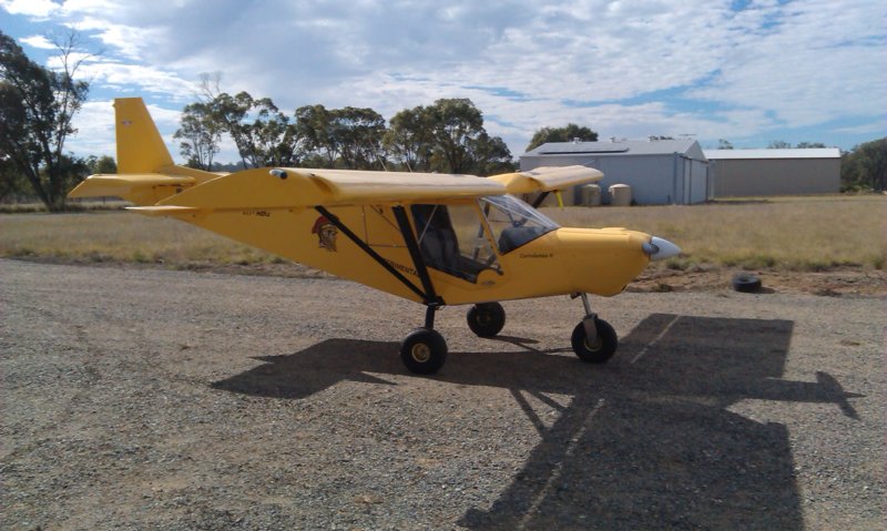

derekliston Posted July 25, 2018 Posted July 25, 2018 I have a 2200 Jabiru in my CH701 and I am totally happy with it. Lighter, simpler, cheaper than the Rotax. Any difference in take off distance over the 100hp Rotax is so small as to be negligible unless you are flying in and out of incredibly short strips. Any problems that the engines had in their early days have been pretty much fixed. There are a lot of Jabirus on the airfield that I fly from and they perform well. If you look after (properly maintain) them they will look after you.
Marty_d Posted July 25, 2018 Posted July 25, 2018 Beautiful aircraft Derek! Is that a Roman centurian on the side?
facthunter Posted July 25, 2018 Posted July 25, 2018 The jabiru engine is certainly light enough. The type of plane you have would benefit from a bigger and thicker prop so a geared Rotax should be better (certainly in theory).. and the Continental. The trouble with Rotax is cost of bit's and all the pipes, plus Lifed on time and if you neglect the rubbers that hold the carbs on you have a problem with reliability and carb balancing they get rough running on part load. It aways seems difficult to get the engines running hot enough without risking boiling when the OAT changes a lot as it does on a long trip. Adjustable cowl flaps ? Nev
derekliston Posted July 25, 2018 Posted July 25, 2018 There is a bit of a story to that. My registration is VH-ABG, it was first issued to what was the last remaining Short Empire Class Flying boat in Australia it was named Coriolanus who was a Roman General in a Shakespearean play I believe. I named my plane Coriolanus ll and hence the picture of the Roman. 1
