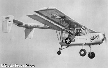

turboplanner Posted July 27, 2018 Posted July 27, 2018 Like this? [ATTACH=full]61272[/ATTACH] If you look carefully is has a slat/flap/aileron arrangement which looks as if it increases the angle of attack substantially, and the tail wheel is quite a bit higher than the mains. I'd suggest this was someone's idea for low level surveillance, flying and landing nose down on the mains, and settling on the rear wheel later, which gave the aircraft stable crosswind solo taxying on battlefield landing sites. Based on the configuration dying out, it probably wasn't a success. Around that time the USAF tried many weird designs, including a vertical take off fighter that sat on the ground, like a rocket, on four tiny wheels. Just imaging what it would be like stopping a big fighter in mid air, getting it to drop tail low, then reversing in a downwards curve on to a landing pad.

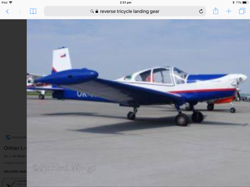

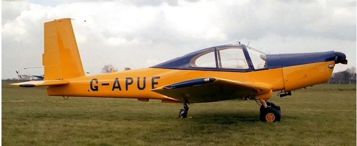

red750 Posted July 27, 2018 Posted July 27, 2018 Another photo of the Meta Sokol, a Czechoslovakian aircraft of the late 1950's.
David 95 Posted July 27, 2018 Posted July 27, 2018 It depends if the mains are forward or aft of the c/g, If they are forward of the C/G then it is still a tail dragger. The idea of moving the tail wheel forward is to give the rudder more leverage over it and hopefully be more controllable. pretty much as Red said.I Have my doubts as too how effective it is. 1 1
facthunter Posted July 28, 2018 Posted July 28, 2018 The issue is IF the mainwheels are ahead of the centre of gravity. The tailwheel (or nosewheel) determines the pitch it sits at and may be actively steerable or castering. Any time any wheel ahead of the Cof G is carrying the majority of the mass of the plane it's directionally unstable. In both designs the Mains are built much stronger as they are designed to carry the bulk of the forces, and should be flown in accordance with that principle. Nev 1
Yenn Posted July 28, 2018 Posted July 28, 2018 Looking at the Meta Sokol picture I reckon the mains must be ahead of the C of G. Otherwise It would sit in a funny configuration.
Thruster88 Posted July 28, 2018 Posted July 28, 2018 You are onto somthing there Yenn, five on the aus register hope they are all still flying.
Downunder Posted July 28, 2018 Posted July 28, 2018 If the mains were BEHIND the CofG wouldn't the prop be ploughing fields? 3 1
kasper Posted July 29, 2018 Posted July 29, 2018 Not unsurprising the kit built tailwheel Europa that had the “tailwheel” up under the fuselage had a very popular modification to have a tailwheel down at the end. I’ve three lovely cast tailwheel yokes and wheels from ones I worked on the convertion of
facthunter Posted July 29, 2018 Posted July 29, 2018 Having it at the rear is simpler in many ways and can be less substantial to do the same job.. If you want to retract it, coming forward is almost a necessity.. I've flown a Sokol and they are not so different but you were told to not abuse the tailwheel. It's still a real taildragger in principle, except the geometry prevents a real nose high landing. With effective flaps this is unnecessary anyhow. Steer with the tailwheel? Yes for sure. Set it up to work properly .That's why you keep the stick right back after landing, to keep the weight on it especially on planes with an undersized or shielded rudder.( Not when taxiing downwind though). Nev
