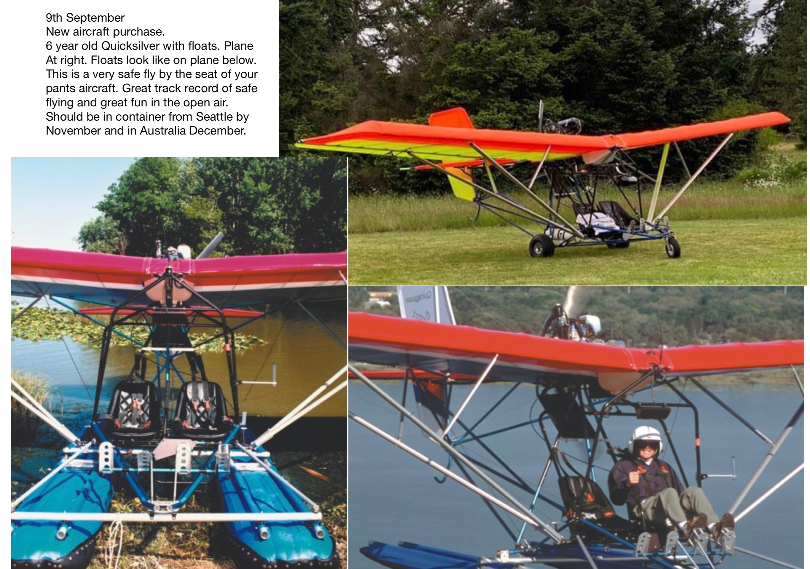

Mike Gearon Posted September 9, 2020 Posted September 9, 2020 I’ve purchased a quicksilver 2 seater in USA. Has a 90hp rotax and optional floats. Looks straight forward to bring to Australia. My seller is going to strap into the 20’ container. Any traps?

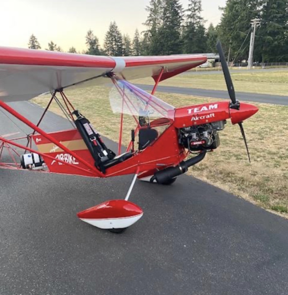

Mike Gearon Posted September 11, 2020 Posted September 11, 2020 I’ve paid for the QS. Missed one for 12.5k that sold in 2 hours. This is much newer. Engine has 60 hours. Floats and parachute. 20k. USD There’s also an airbike for 10k available. See here. If anyone wants an airbike we could split container. It’s coming from Seattle.
