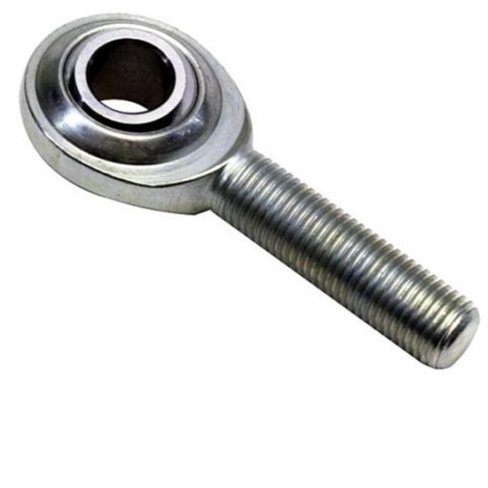

sandman Posted September 4, 2018 Posted September 4, 2018 can someone please tell me the bearing and thread or part that is used between the aileron bell crank and the aileron control horn, the aluminium tube the bearing screws into is ok just the bearings need replacing.
sandman Posted September 4, 2018 Author Posted September 4, 2018 The rod end I think is what I'm after, and where can I buy them from.
Kiwi Posted September 4, 2018 Posted September 4, 2018 Most bearing / bolt retailers should stock them, just take the old one in. They are right hand threads on both ends, and measures the total distance of the setup before you remove them. Also don't mention that they are off a aircraft ;-) 1
old man emu Posted September 4, 2018 Posted September 4, 2018 Pull it off. Clean off the rust and look for ID markings on the head.
Yenn Posted September 5, 2018 Posted September 5, 2018 It looks like a Heim rod end to me. Have a look at the Aircraft Spruce catalogue, which is available on line. Under airframe parts it will show heim and a page of dimensions with part numbers.
gareth lacey Posted September 5, 2018 Posted September 5, 2018 A.S.A,P. at Caboolture have them in stock
