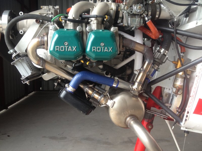

The oil cooler on mine is mounted so the inlet and outlet are at the top ..if they were on the bottom then of course you could get air in the top of the coolerIMG_2745.jpg.5e6690bcc9998922e87709f640787e75.jpg

I reckon it is lazy / silly engineering practise to mount upside down. With mine I did at first consider upside down but as that then required bleed on air issues I planned a fit up the right way up. What helped a lot with this was the alternate 90 degree pipes that Rotax sell that are a tighter route of the oil hose runs and allows easier fitting close under the prop flange of the gearbox on the 912. You will find these listed in the parts catalog. Much better than the bigger / taller 90 degree pipes (Same as those used at the oil can end) that normally come with the engine kits. Cheers
If it's a continuous single tube type (the worst) how you mounted it would not matter. It would purge itself.. When you've got pipes all over the place, it's starting to get messy and not a good situation from the safety and maintenance aspect. You already have water pipes to individual heads., manifold bal;ance pipe, two carbs full dry sump oil lines carbs over exhaust pipe. Compare with a Continental 0-200 with carb ONE under the motor and no need for an oil cooler or radiator.. Nev

I hope you finished this installation and fitted some drip trays (heat shields) under the carburetors?
What size are your oil lines? They look smaller than mine.
