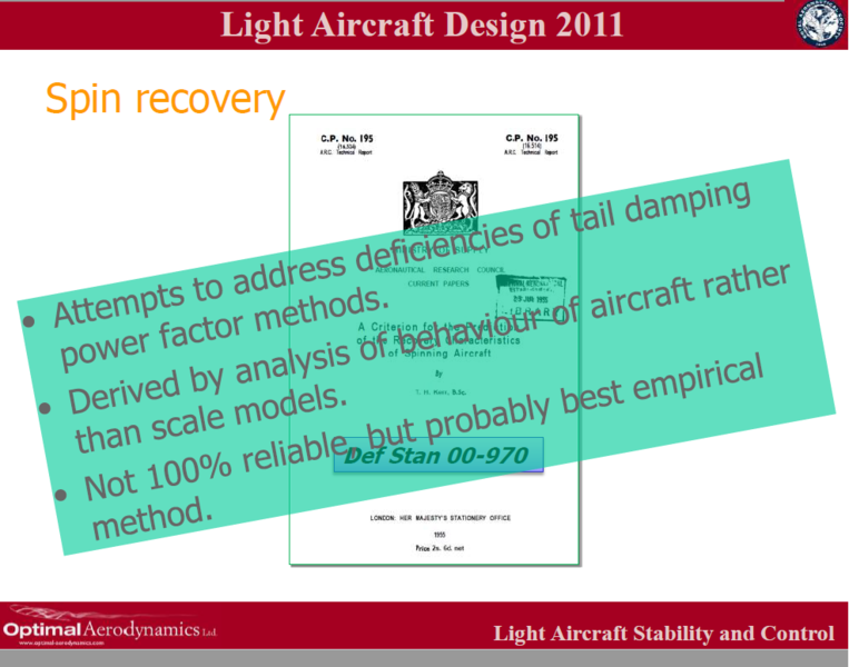

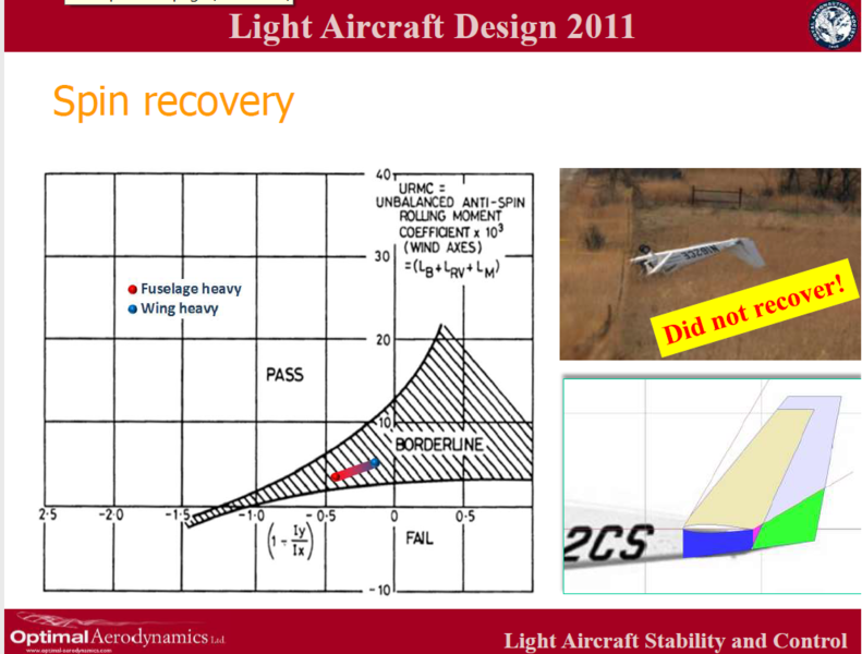

djpacro Posted October 7, 2018 Posted October 7, 2018 Quote This is taken from Darrol Stinton's book "The Design of the Aeroplane" which might be of relevance or interest. Furthermore Stinton notes that spin damping is better when there is a deep rear fuselage and when there is rudder area beneath the tailplane and elevator. None of these are designed into many modern aircraft including the above as so many LSA type aircraft become very thin towards the real fuselage including this aircraft. Interestingly Stinton (perhaps controversially) writes in relation to the above quote "much of this design wisdom is being lost". Yep, Cessna designers "lost it" for the Skycatcher at first. I have run numbers on quite a few aeroplanes using that method and, as it says here, it is quite good to use in preliminary design. The report detail is at http://naca.central.cranfield.ac.uk/reports/arc/cp/0195.pdf The NACA Tail Damping Power Factor is more simple but not as good as a predictor https://ntrs.nasa.gov/archive/nasa/casi.ntrs.nasa.gov/19930082166.pdf 1
Blueadventures Posted October 7, 2018 Posted October 7, 2018 Quote It is not the only aeroplane around with those instructions - the early Robin 2160 is another however the Robin has a very big rudder but when they went for American certification the FAA insisted on PARE to stop the spin per FAR 23.I'm certainly interested in seeing the spin test report for the Bristell. Even for types which are not approved for intentional spins the scope of testing is quite comprehensive. Similar type to the Bristell: [ATTACH]62073[/ATTACH][ATTACH]62074[/ATTACH] Abosurely agree, and regardless of the thoroughness when compiled it would be worthwhile revisiting some more testing or re verification of the pilots notes. Need to identify if the aircraft is a primary contributing factor. I have a friend with one of these and he is interested about these matters. Cheers 1
