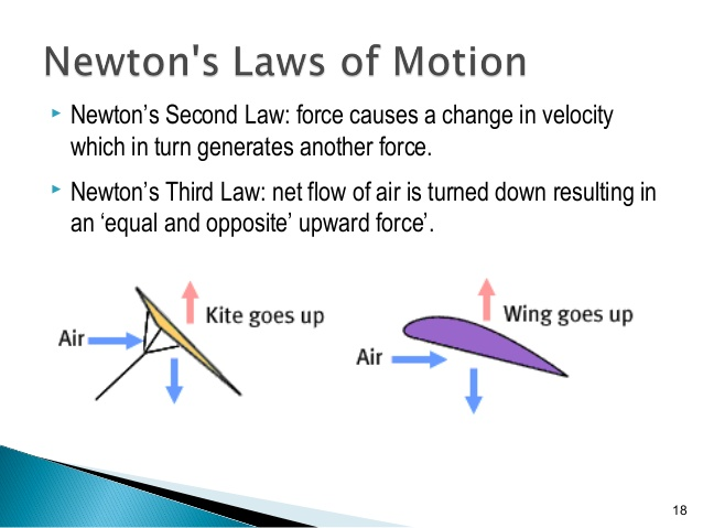

M61A1 Posted October 12, 2018 Posted October 12, 2018 Quote In other threads this has been discussed in some detail. I am in the Wright camp, lots of aerobatic aircraft fly quite well with symmetrical wings. If strength was not an issue planes could fly with paper thin wings. Yes, the Newton camp argue that a symmetrical wing flies so the Bernoulli theory is wrong. The airflow though, is not symmetrical. My understanding is that it is more complex than just one or the other, but both apply. 1
