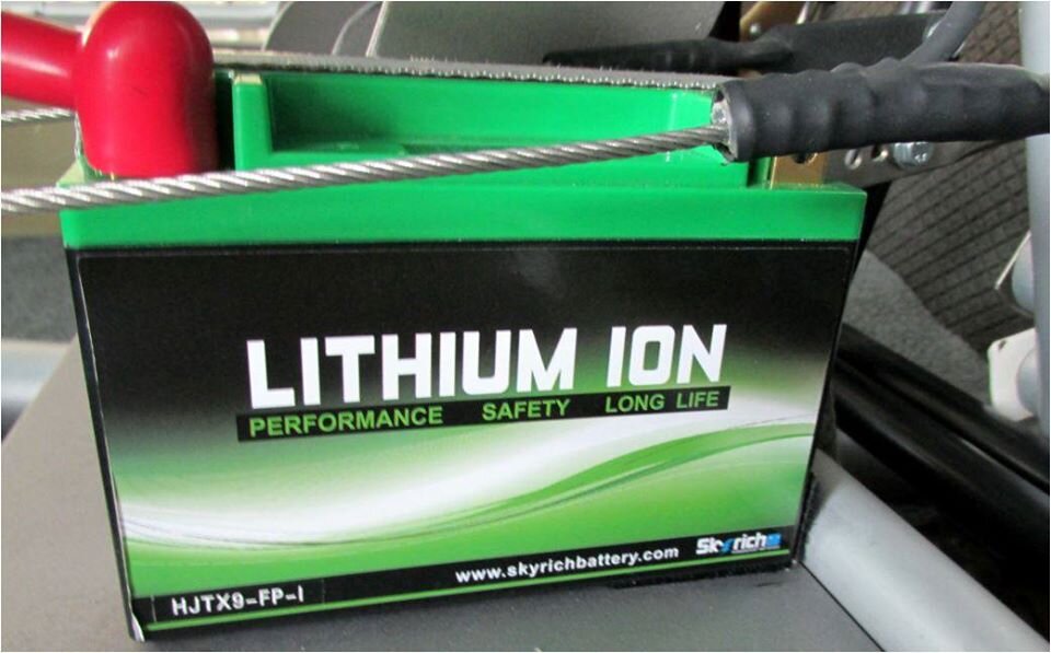

Blueadventures Posted December 28, 2019 Posted December 28, 2019 I see these Lithium Ion batteries are being used by one of the skyranger dealers overseas for Rotax 912 setups. They may be an ok type of battery at only 0.7kg. 185mm long, 79mm wide and 192mm high. Anyone using these. Cheers.
Kyle Communications Posted December 28, 2019 Posted December 28, 2019 Not by me thats for sure when on a Rotax

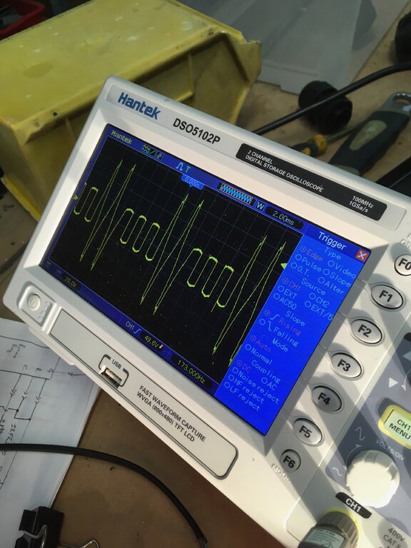

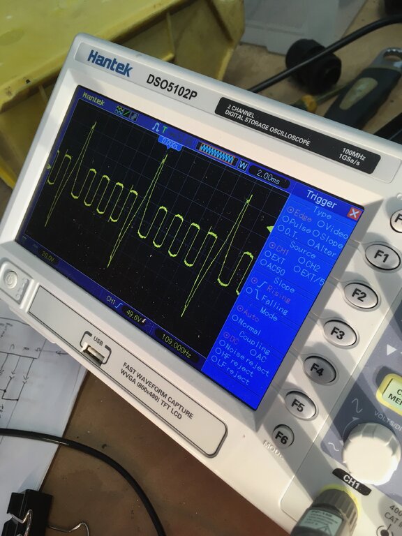

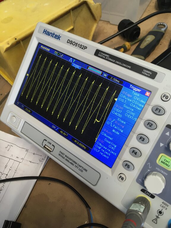

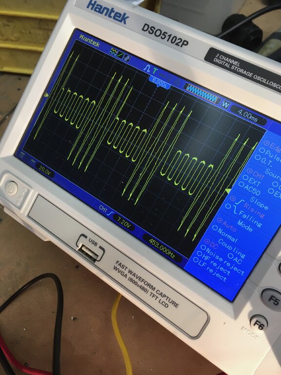

Kyle Communications Posted December 29, 2019 Posted December 29, 2019 I would have to agree. I'll take the extra 5 odd kilos for an AGM over one of these at the moment. I really don't think the Rotax regulator is up to it. My ODYESSEY is still running strong after close to 7 yrs. Perhaps at 10 yrs I'll look at how they are going if my battery needs replacement. I have been involved with the development of a new reg for the Rotax generator. The Rotax is certainly not a nice presentation to the reg and if the reg ever goes funny with either a bad earth or some sort of funky failure the lithium will most likely end up being a 4000deg fireball. Even with the internal protection circuits some of them have. The good old AGM or even a lead acid battery is a far better idea for this type of std generator and regulator. If your electrically minded you will see the unloaded output from the rotax which is in the range of 50V peak to peak as you can see on the cro. With our reg you can see what happens as we use the amount of each cycle which is over 400hz needed to supply the current to a load. The Rotax is good supposedly for 18amps but ours will limit the charge current 12 amps into the battery and clamps the voltage very fast to maintain the correct dc level to the battery

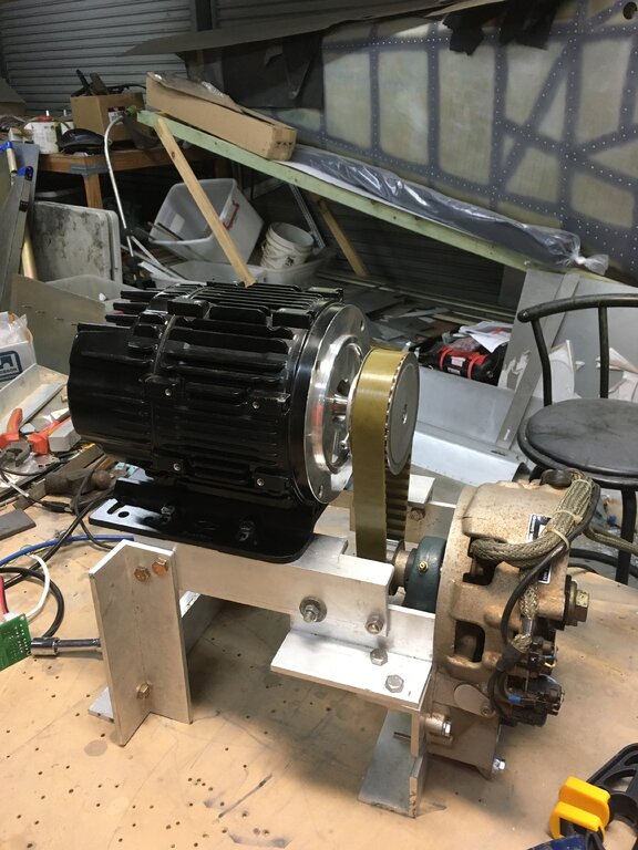

Kyle Communications Posted December 29, 2019 Posted December 29, 2019 A rigorous testing program is to come yet. The first test unit should be going on a aircraft in a couple of weeks. The base design is done and works very well on the test bench and the pics should give you an idea of what it does and does very well. There is some failsafe design on board as well. We have been using my test rig I use for testing the CDI modules I make for the rotax. It can get to 5200 rpm driving the rotax generator so we do have a real world test bed for it which allows the proving before it even gets to a aircraft 1
