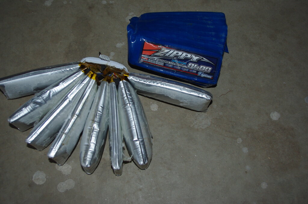

Bruce Tuncks Posted January 18, 2020 Posted January 18, 2020 A few days ago I ruined a good LiFePO4 battery. This battery was about 3 years old and originally bought as one of a pair to start the Jabiru. Well the Jabiru only needed one battery, so this one was a spare and was used for the glider radio and an electric chainsaw. It was in good condition until... I had just used the chainsaw and decided to give the battery a quick recharge before going to the club to fly the glider. I used the wrong setting on the charger ( the Nicad setting ) and overcharged the battery badly ( 20 volts instead of 14.4) . The cells puffed up and burst out of the plastic cover. Bugger, those batteries have increased in price since 3 years ago, this has cost me about $150. 1
