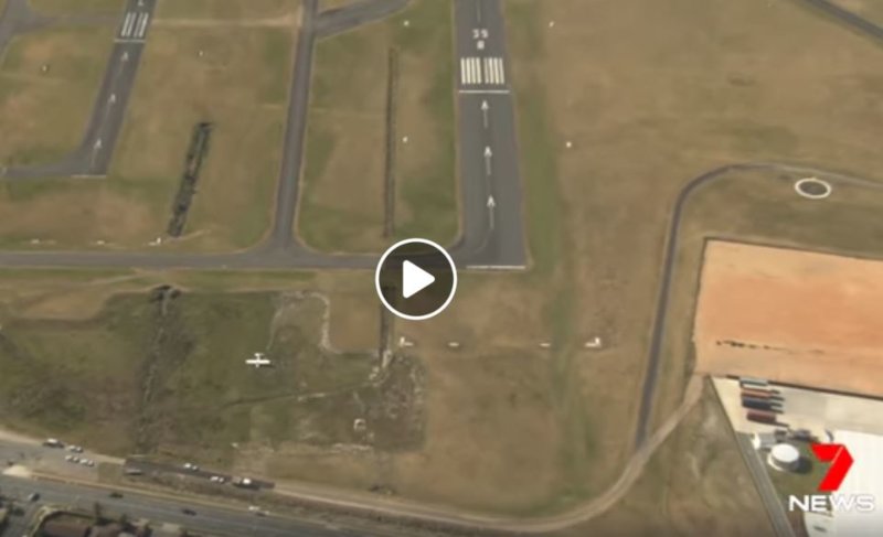

red750 Posted October 13, 2018 Author Posted October 13, 2018 Video of incident at Moorabbin There is a report on the helicopter accident on the Herald Sun website but it is subscription only, and I'm not a subscriber.

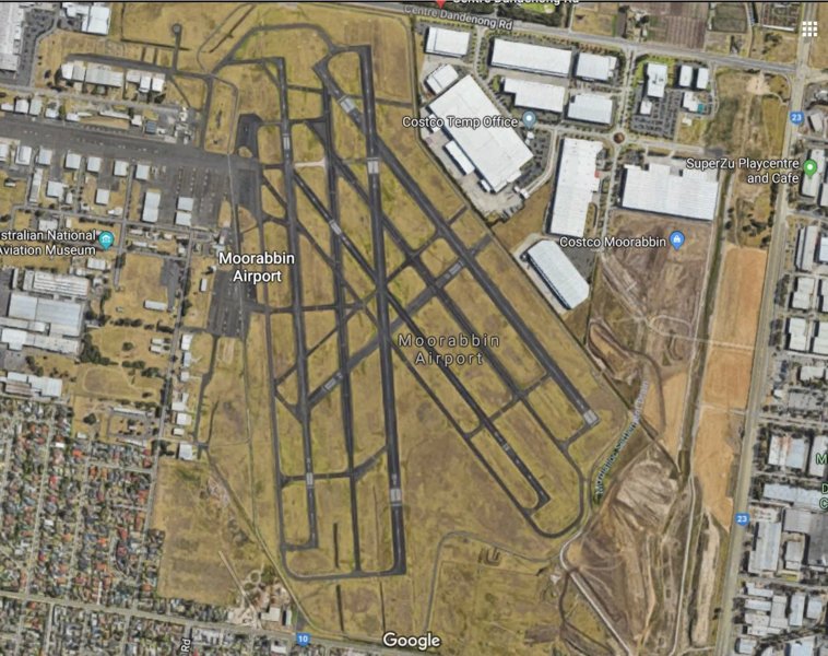

turboplanner Posted October 13, 2018 Posted October 13, 2018 Footage: Herald Sun/Channel 7 Hard to say whether he has gone off the end of 17C or 17R or the taxiway between them, or was heading for 35C, touched down early and did a U turn. Bigger scale to right: Google Maps.

kaz3g Posted October 14, 2018 Posted October 14, 2018 Turbo...looks awfully like he used 17 Centre to me. Kaz
planesmaker Posted October 14, 2018 Posted October 14, 2018 He obviously needed to go around, to run off the end and still travel that far in a 172 I'm amazed I am assuming he was landing?
