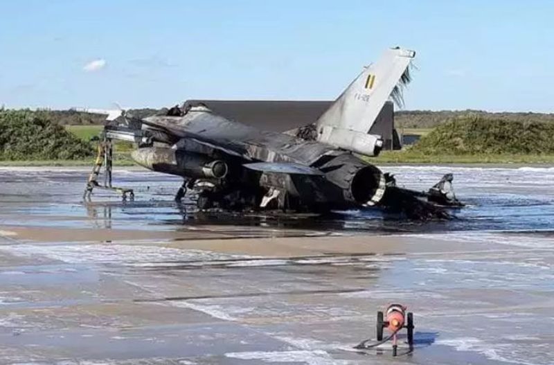

A multi-million dollar Belgian warplane was destroyed when a mechanic accidentally fired a cannon during routine repairs.
The $27 million F-16 fighter jet rapidly caught fire and exploded at an air base south of Brussels, reports the UK Telegraph.
The mechanic was working with a colleague on two other aircraft in a nearby hangar when he accidentally fired a six-barrelled Vulcan cannon.
http%3A%2F%2Fprod.static9.net.au%2F_%2Fmedia%2F2018%2F10%2F15%2F17%2F43%2Ffighterrunway.jpg
The burnt-out Belgian Air Force F-16 after it was accidentally hit by cannon fire at Florennes Air Base in the country's south. (twitter)
His misfire completely destroyed the aircraft that had been refuelled ahead of a flying sortie.
Another F-16 jet was also damaged.
Both mechanics were injured during the incident last Thursday.
Boris Morenville, head of the Belgian defence trade union, said the plane’s destruction was accidental.

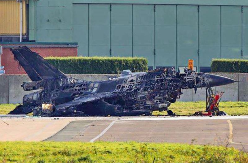

http%3A%2F%2Fprod.static9.net.au%2F_%2Fmedia%2F2018%2F10%2F15%2F17%2F43%2Ffighterskeleton.jpg
Authorities said no one was injured after the Belgian warplane exploded at the air base. (twitter)
"We may be thinking about human fault or technical failure, but in any case we have not yet been warned of an intentional act," he said.
About 30 firefighters were called to the incident along with ambulances and other emergency workers.
The air base commander, Colonel Didier Polome, said he was relieved that only two people were injured when the plane exploded.
“You can’t help thinking of what a disaster this could have been," he said.
Belgium’s Ministry of Defence is investigating the incident.
