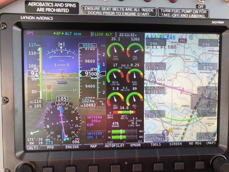

I get a wealth of data from the Dynon Skyview, but to be fair, the spreadsheet is merely a collection of (constantly updating) data points (from photos like the attached) over 2 flights on different days across a range of altitudes, temperatures, QNH etc etc. Lots of variables involved, but good enough for some fairly good predictability when flight planning future trips.
The Auxiliary pump was mistakenly left on for the early part of that flight test (it is capable of being left on long-term). I tend to only turn it off after I’ve climbed past 2000 AGL to give me time to rectify any (unlikely) negative fuel-surge surprises necessitating re-starting. That’s never happened yet, but I usually notice a momentary fuel pressure drop in the gauge when I switch it off each time.
Distance per litre is a quick visual reference for me, along with the Range readout (vs Distance to Go readout), and wind vector display. It helps me find the optimum altitude under actual MET conditions, all during climb out, and throughout a cross country trip.
From this recent photo, I read a data point of 110 KTAS @ 17 lph, 5260 RPM, MAP 20.1, 9500 ft (DA 10492 ft) OAT 8 degrees, QNH 1024
I calibrated the k-factor for the Dynon fuel-flow by my record-keeping of actual fuel to fill at the pumps along my trips.
