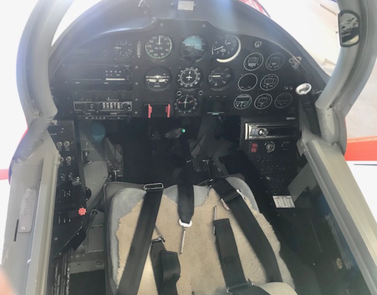

Flightrite Posted June 1, 2020 Posted June 1, 2020 Shame they don't have a "Hard on" emoticon...... I've seen some damn nice RV8s, a bit out of my budget at this time though. A real mans 8, fighter like interior/controls? 1
