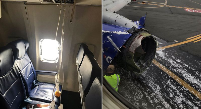

http%3A%2F%2Fprod.static9.net.au%2F_%2Fmedia%2F2018%2F11%2F15%2F13%2F50%2Fnewwindow.jpg A flight attendant said when she looked out the window, she could see that one of the plane's engines was shattered, and there was blood on the outside of the aircraft.

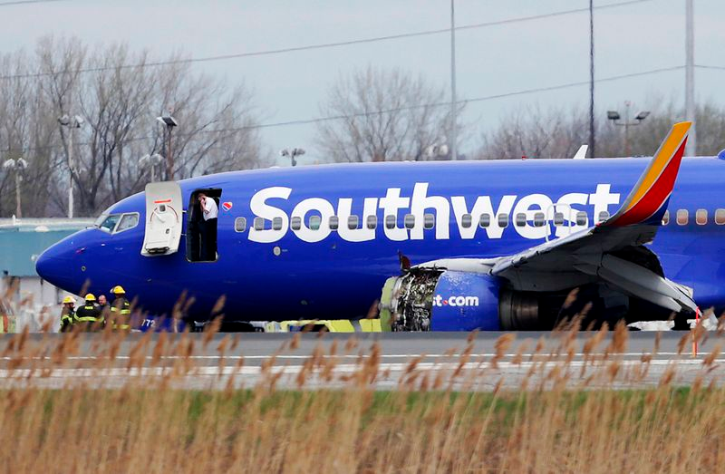

Pilots Tammie Jo Shults and Darren Ellisor landed the crippled Boeing 737 in Philadelphia. The passenger in the window seat, Jennifer Riordan, was fatally injured — the first death on a US airline flight since 2009. Eight other passengers, including at least one of the men who helped pull Riordan back in the window, were hurt.
The hearing in Washington focused on design and inspection of fan blades on the engine, made by CFM International, a joint venture of General Electric and France's Safran SA.

An official from CFM defended the design and testing of fan blades like the one that snapped on the Southwest plane as it flew high above Pennsylvania, triggering an engine break-up that flung debris like shrapnel into the plane.
After the fatal accident, CFM recommended the use of frequent and more sophisticated tests using ultrasound or electrical currents.
Another Southwest jet had suffered a similar blade-related engine breakup in 2016 over Florida.
The pilots landed the crippled plane in Philadelphia. The National Transportation Safety Board hearing in Washington focused on design and inspection of fan blades on the engine.. (AP)

Since the deadly flight, widespread inspections have turned up eight other fan blades on similar CFM engines that also had cracks. The fan blade that broke was last inspected six years earlier and, it was determined, suffered from metal fatigue even then — but it went unnoticed by a less sophisticated exam used at the time.
Fan blades have been thought to have no real lifetime limit. CFM and FAA officials said they were now considering whether blades must be replaced at some point even if they don't show wear.
