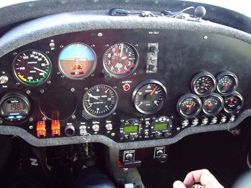

Guest brentc Posted January 23, 2008 Posted January 23, 2008 Yep, that's the one Chris. It wasn't cheap, but that being said was probably only about $100 more than a non-tso'ed Electric Turn Coordinator from spruce. I have used this same unit in an aircraft that had pitch on it, but I didn't find it too successful. If you look at the pic you'll see the marks at the top; on a normal Turn Coordinator they would be on the sides rather than the top. It works exactly the same as a normal turn coordinator except that it's graphical and if you exceed a rate 1 turn, it just keeps turning exactly the same as the AH does. Startup time is 4 seconds and it's a solid state electronic gyo. You can even turn it on in a 60 degree turn and it will align itself automatically. Whilst I would fly through cloud if I had to with the turn coordinator, it's more reassuring with the graphical version, so if you had an AH failure you could just switch over to that. It wasn't a concern to me that it doesn't have pitch as the pitch on a normal AH is barely usable as I said the VSI is a better indication. I also have a Garmin 296. It doesn't have an AH, however it has a turn coordinator. I wouldn't like to rely on it unless the world was almost coming to an end because it's based on GPS / Sattellite information and is not a gyro as such. Techically if you were upside down in cloud it would still be indicating ops normal! If I was to do my dash again, it would have a 4 or 7 inch Dynon EFIS or similar which is electric and has a battery backup. Then again, if you lose electrics you are in the poo a bit if you are relying on them. For NVFR you only need a single source of power for AH/DG/Turn and for IFR you need backups so you'd have to have Electric EFIS and Vacuum I guess, like the Cirrus.

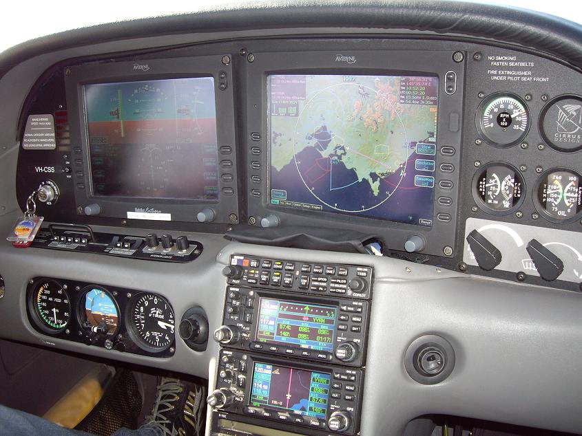

Guest brentc Posted January 23, 2008 Posted January 23, 2008 Pic attached of my dash with TruTrak fitted. Pic attached of Cirrus SR20 dash.
bushpilot Posted January 23, 2008 Posted January 23, 2008 Geez Brent, that Cirrus is full-on! Your Jab dash looks very user friendly also... So, bottom line, that TruTrak could be used in lieu of a regular AH, right? Txs Chris

Guest brentc Posted January 24, 2008 Posted January 24, 2008 Geez Brent, that Cirrus is full-on!Your Jab dash looks very user friendly also... So, bottom line, that TruTrak could be used in lieu of a regular AH, right? Chris, I'd say that was a fair assumption. Next time I go up I'll treat the Turn coordinator as a pure AH and see how I go and if it holds up. As far as I recall, it reads exactly the same as the vacuum artificial horizon and you could use it, which realistically was my plan when purchasing. I was hoping that in the event of VFR over the top if I had an engine failure and thus vacuum failure that I could use the tru-trak safely to descend through cloud.

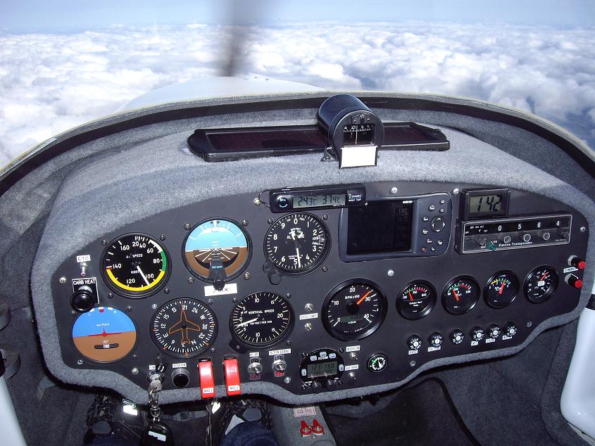

Guest brentc Posted January 24, 2008 Posted January 24, 2008 Chris / Bushpilot, pic attached is of the top end TruTrak fitted in a Jab. From memory around $1,300 and it has an electronic DG built in which is given by the built in GPS. Even at that price, still far less than paying $1,400'ish for a Vacuum pump and $700 for a vacuum AH. Not bad value for 3 instruments in 1.
