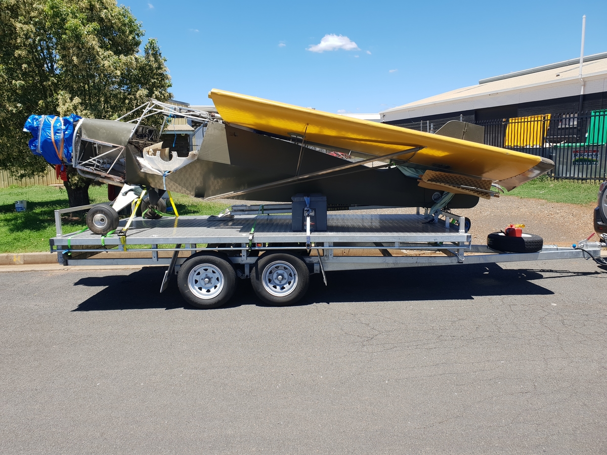

BackcountryAeropup Posted January 18, 2019 Posted January 18, 2019 I thought I would share my Aeropup project I have just purchased. The plan is to progress and post as often as possible. 4 1 1

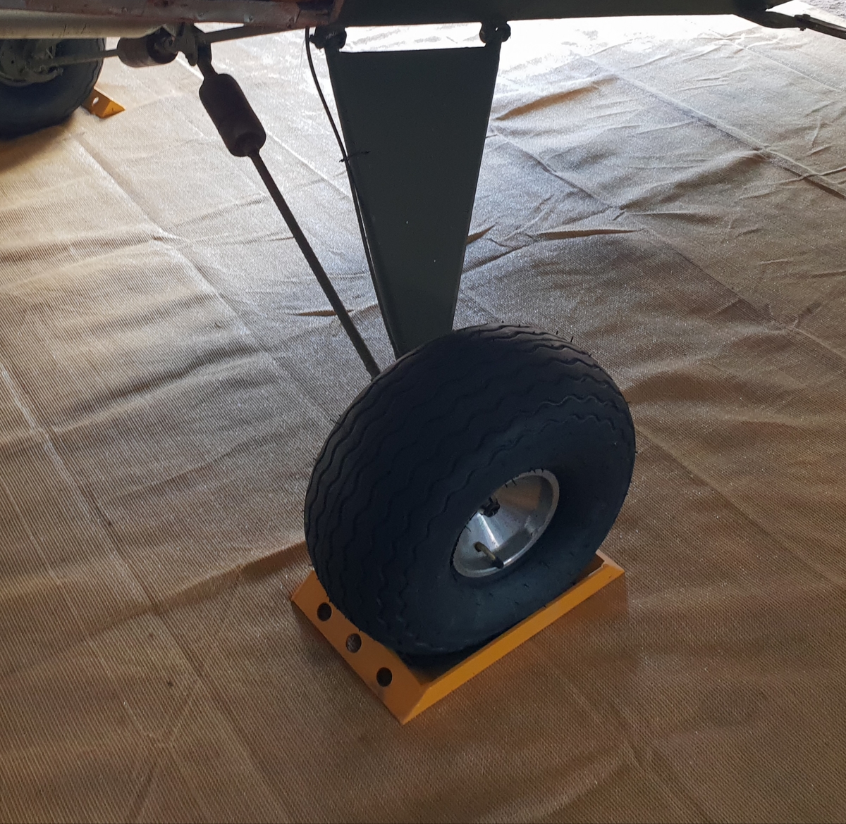

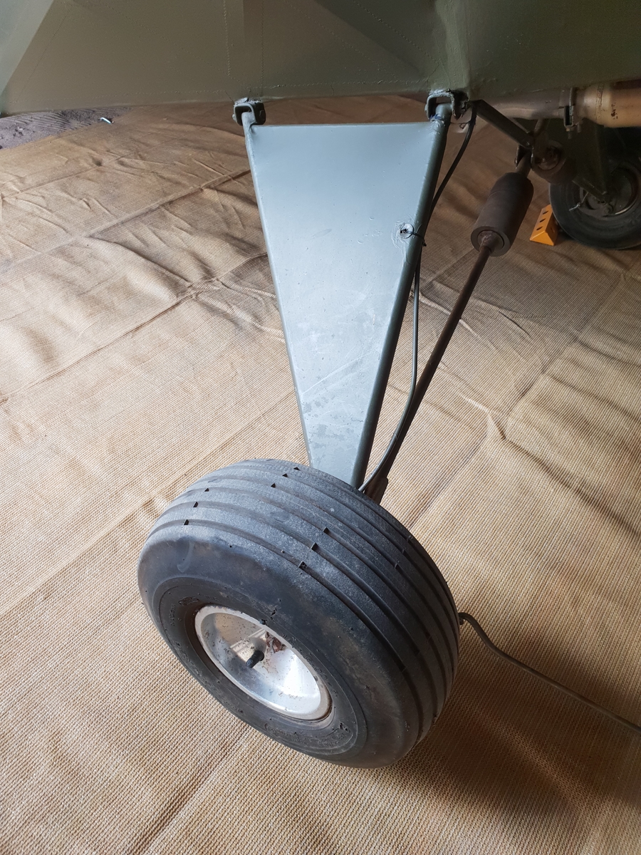

BackcountryAeropup Posted January 19, 2019 Author Posted January 19, 2019 Apart from a bit of cleaning since the aeropup has settled in her new home I have swap the tyres from the 15's to the good old turf glide 18.5's. ultimately I would like to put a set of Aeroclassic 22'' tyres on but the money will be best spent else where. I will get her in the air first. 1
BackcountryAeropup Posted January 19, 2019 Author Posted January 19, 2019 Another change I made straight up was when I got the pup it hade a flat back tyre so I sourced a solid electric wheel chair tyre to replace it and eliminate that problem. 1

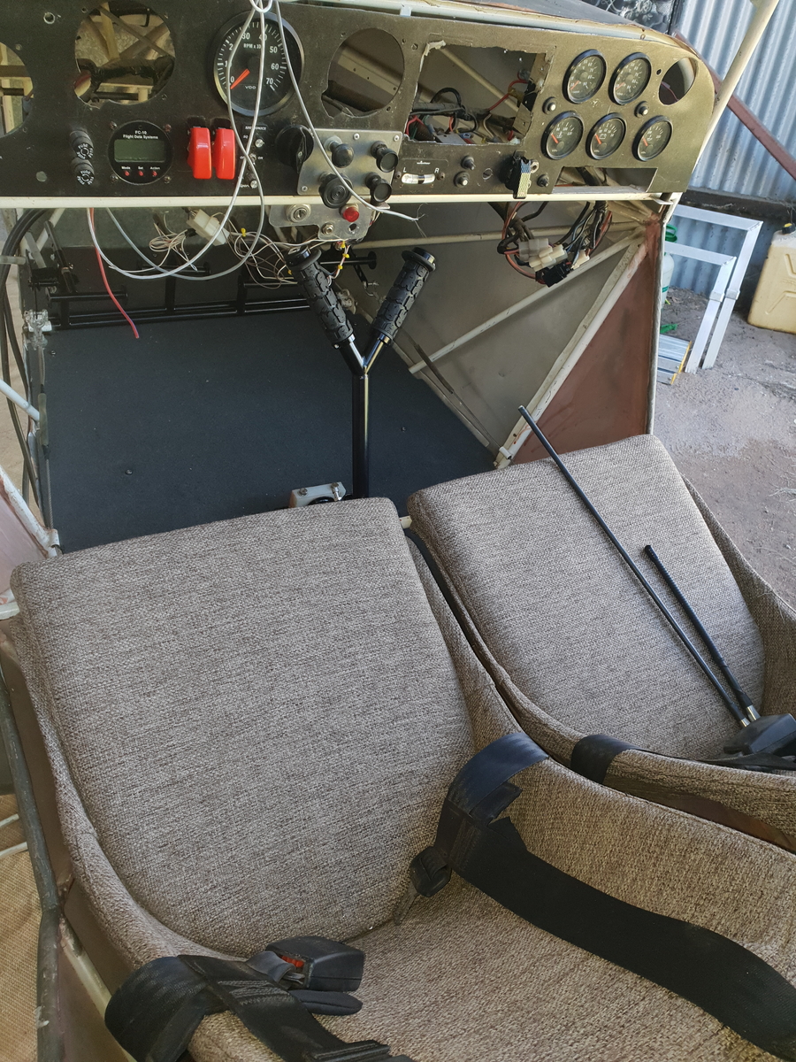

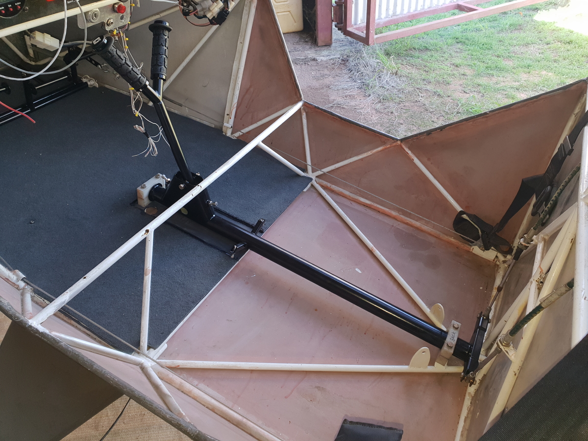

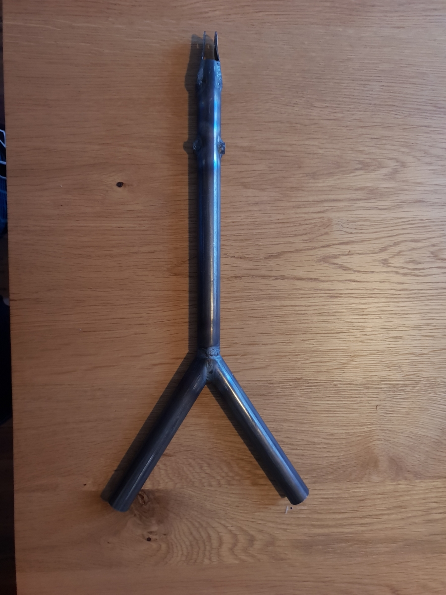

BackcountryAeropup Posted February 8, 2019 Author Posted February 8, 2019 Due to a non air worthy style modification to my control stick I decided to remake a new one with a modification of my own. I thought it would be better fabricating a zenith style stick for more comfortable control and a lot better for duel control when needed.

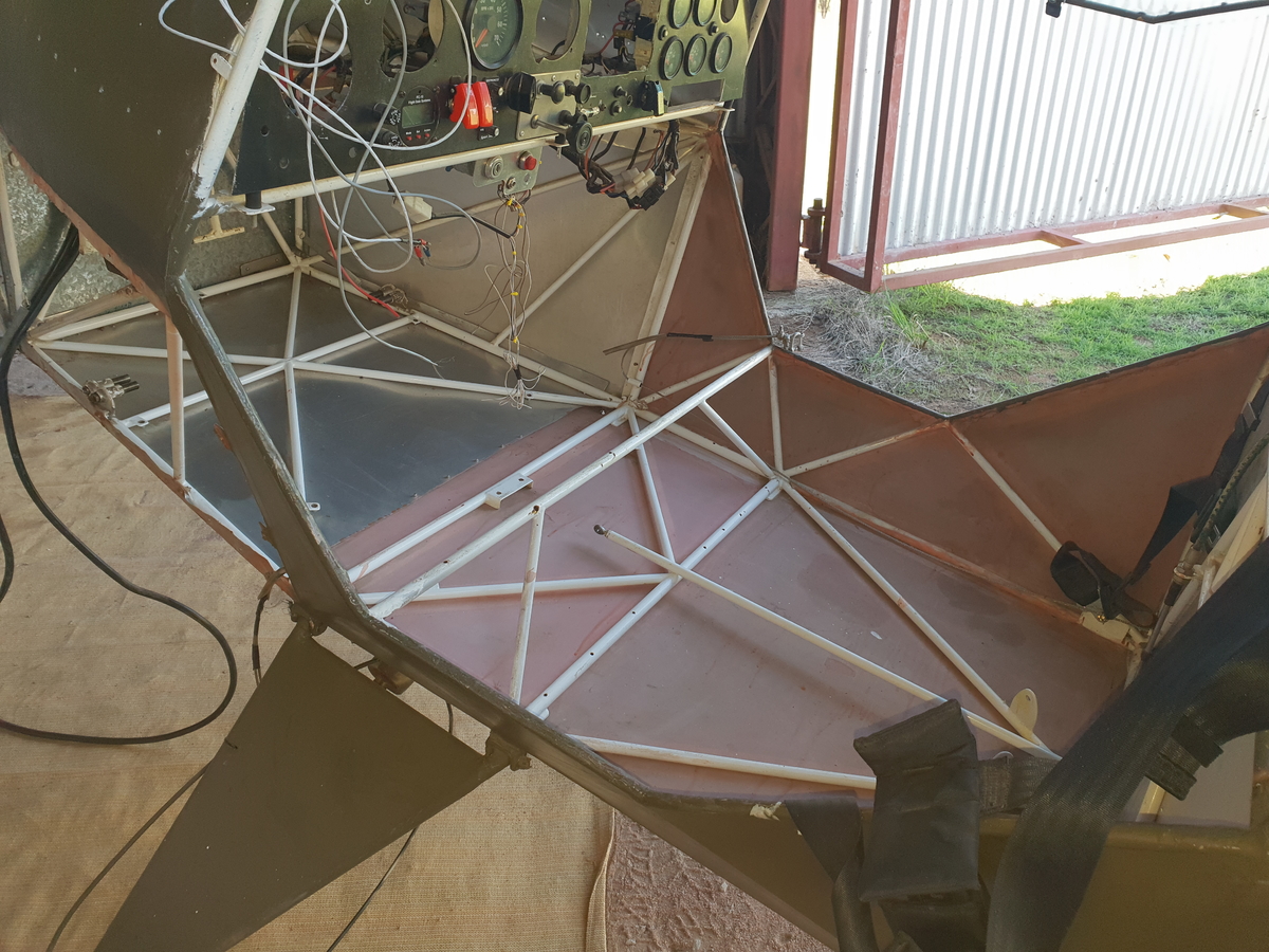

BackcountryAeropup Posted March 31, 2019 Author Posted March 31, 2019 I spent the last couple of months taking off parts getting them sand blasted and powder coated again. I took out the old floor for replacement.

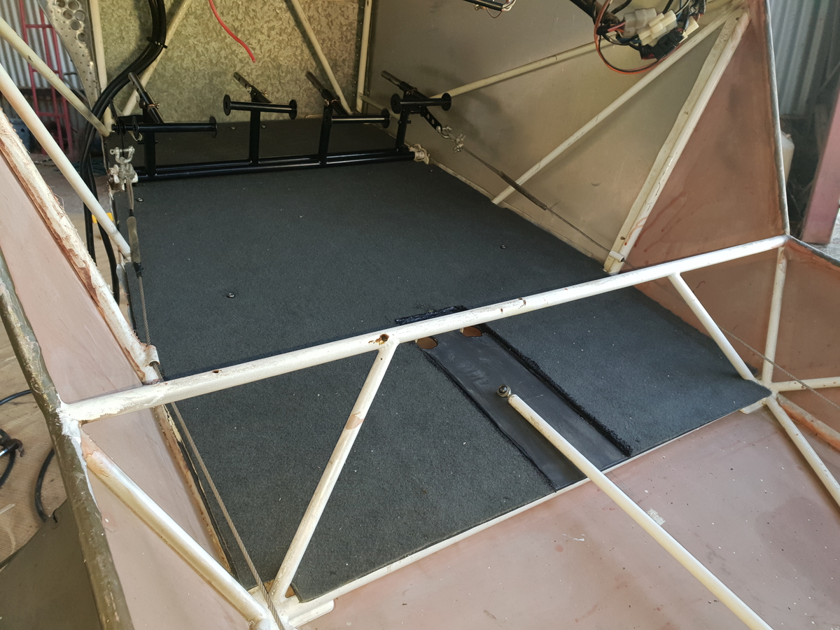

BackcountryAeropup Posted March 31, 2019 Author Posted March 31, 2019 I got the parts back from powder coaters and made a new floor board. This week I splashed a bit of paint on it and this time I stuck some marine carpet down. When I got it the floor was unpainted and weathered a bit. I spent a good part of today putting it back together and this is how it turned out. 3 1

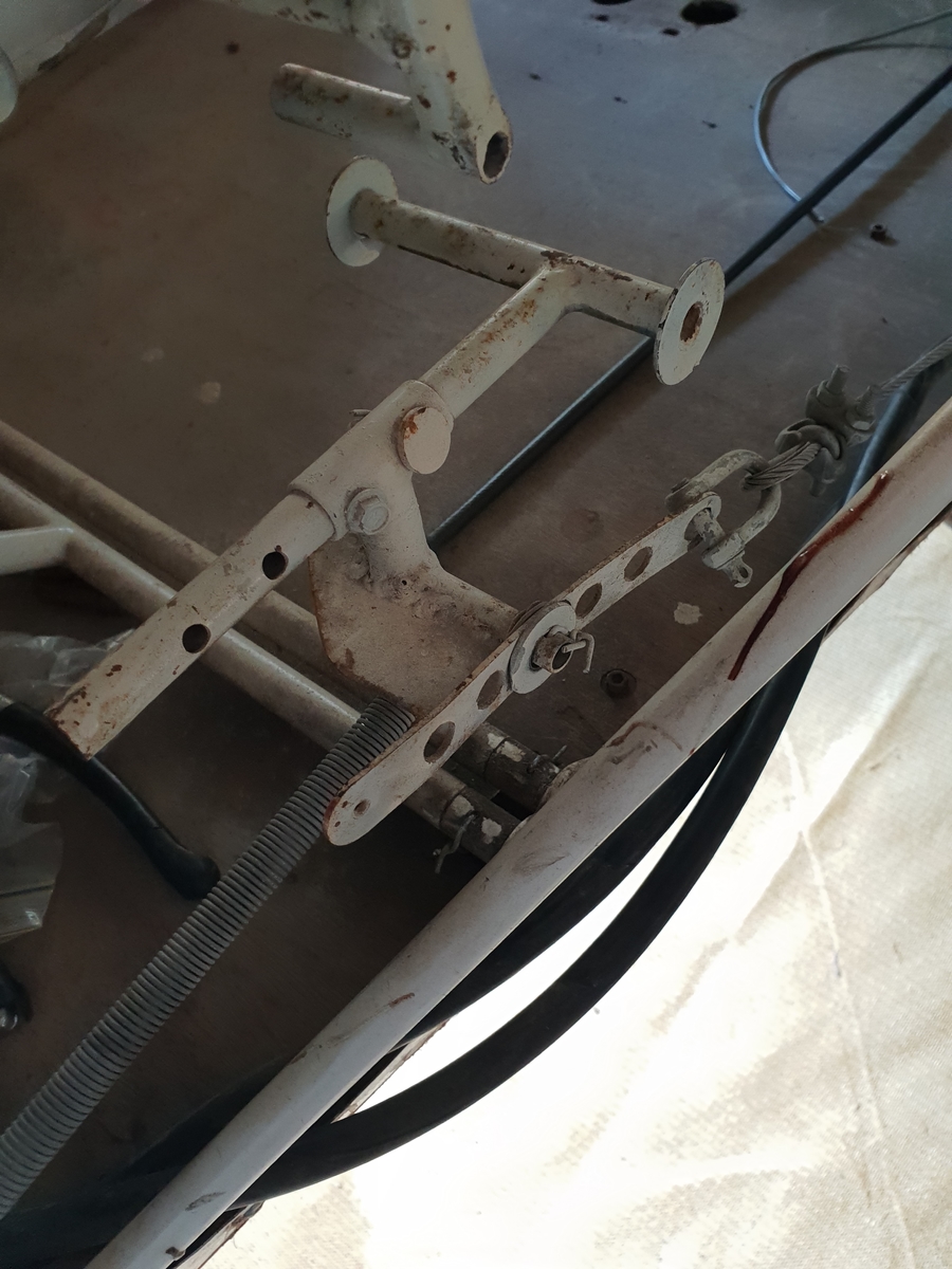

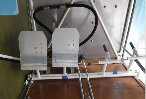

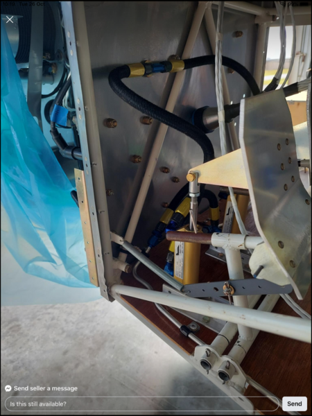

Snakemoose Posted January 13, 2022 Posted January 13, 2022 Mate could I see toe brakes a few pictures up? If so I would love to know how they are setup.
