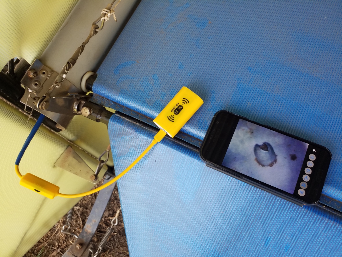

Thruster88 Posted February 1, 2019 Posted February 1, 2019 Cheap $27 endoscope looking for cracks in the main boom inside the stainless sleave at the forward horizontal stabilizer spar on a thruster. Very impressed how good it works. That's a 3/16 stainless pop rivet.

Thruster88 Posted February 2, 2019 Author Posted February 2, 2019 Did you find anything? What have you heard? Mine looks sound from the outside. Saw this point fracture on a Gemini at Holbrook 25 yrs ago. Not fatal but still not good. Rgds Don Did not see any faults and have not heard of anything but if it was to crack it would happen inside the stainless brackets and not be visable from the outside. Mine has about 1300tt nearly all by me and no training.
