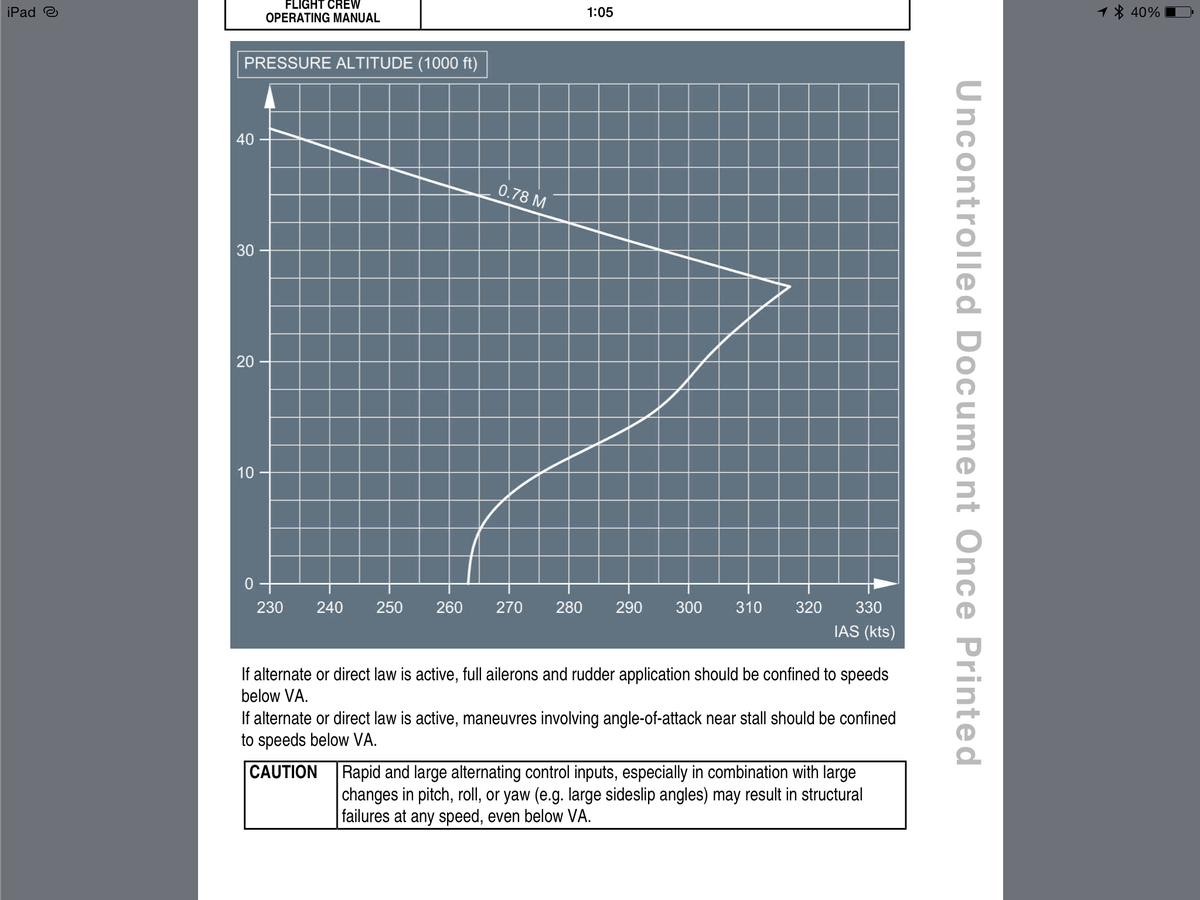

djpacro Posted April 10, 2019 Posted April 10, 2019 I didn't see that either video actually explained the correct definition of Va (although I skipped thru that long video so may have missed it but don't think so as I didn't hear some aspects of Va mentioned at all). https://www.safepilots.org/documents/SAIB_Maneuvering_Speed.pdf
poteroo Posted April 10, 2019 Posted April 10, 2019 I didn't see that either video actually explained the correct definition of Va (although I skipped thru that long video so may have missed it but don't think so as I didn't hear some aspects of Va mentioned at all). https://www.safepilots.org/documents/SAIB_Maneuvering_Speed.pdf This is a very real subject for concern. Va is the IAS at which full deflection of the most effective control, (usually elevators because of the leverage), which will cause the aircraft to stall, but beyond which structural damage or actual failure may occur. The classic Vn diagrams illustrate this. The manufacturer should have built the aircraft, and tested it, so that they can quote actual load factor limits, airspeed limits, and stalling speed guides to the purchaser via the POH. In the case of most RAAus non-aerobatic types, the Load Factor range is usually +3.8 and - 1.9, with a Vs below 45KIAS. The Va will always be less than Vno, (bottom of yellow arc/top of green) - beware if you mistakenly believe that in the green is ok in all conditions. It is calculated from the Vs, and so Va varies with the actual weight of the aircraft - the usual practice is to quote Va at MTOW. As a working example, I'll use our Brumby 610 24-8554. Vs @ 600kg = 44 KIAS so Va = sq rt of LF 3.8 x 44 = 1.95 x 44 = 86 KIAS, or 14KIAS below Vno! (Brumby quote 88KIAS for the Vs of 44, but I have seen a Vs of 42 given = 82KIAS Va) Vs @ lower weights is lower than 44, (depends on test flying), but the calculated Va will always be lower than the Va as shown in the POH. Some references vary Vs by actual MTOW/MTOW x Vs, although this would need to be determined for each aircraft. The Va for full extended flap is based on the sq rt of 1.9, and happens to be the same as were the aircraft to be subject to -.1.9 LF in clean configuration. In other words - don't extend flap in rough air, and avoid inverted flight! My RV9A is also quite a Va exercise. It is quoted as having a Va of about 109-112KIAS in the VANS references, but I can't make that number work. My Vs at MTOW of 795 kg is 53KIAS, and using 3.8 LF this calculates out to a Va = 103KIAS. As a precaution, I use 100KIAS as my absolute tops when things get a bit rough, and if it is seriously so: then I try for 80-85KIAS max. (keeping somewhere near midway Vs and Va). Now, the question arises - why are manufacturers Va numbers higher than my calculations from the accepted formulae? Could our Vs observations be in error due to the blurry stall characteristics of many RAA types? Is it an attempt by manufacturers to present their aircraft as 'tougher' and more 'capable' than competitors? Cessnas are somewhat the same: I could never calculate a Va for any of my many aircraft over the years which was closer to theirs than 10 KIAS. The next question is - why have there been so few in flight damage or break-up problems reported or attributed in accident reports over the years? Could it be that the majority of owners don't risk flying as they are very much aware of their own skill limitations in turbulence, or they just don't fly in adverse weather full stop, or are our RAAus types actually a bit stronger than the +3.8 / -1.9 LF envelope? I rather think that RAAus pilots do avoid really rough weather because there are so many RLOC accidents attributed to 'wind effects' that the lesson is clear to see. happy days, 1 2
djpacro Posted April 10, 2019 Posted April 10, 2019 This is a very real subject for concern. ..... My RV9A is also quite a Va exercise. It is quoted as having a Va of about 109-112KIAS in the VANS references, but I can't make that number work. My Vs at MTOW of 795 kg is 53KIAS, and using 3.8 LF this calculates out to a Va = 103K .... Now, the question arises - why are manufacturers Va numbers higher than my calculations from the accepted formulae? Could our Vs observations be in error due to the blurry stall characteristics of many RAA types? Is it an attempt by manufacturers to present their aircraft as 'tougher' and more 'capable' than competitors? Cessnas are somewhat the same: I could never calculate a Va for any of my many aircraft over the years which was closer to theirs than 10 KIAS. .... happy days, 1. Calculations must be done using CAS not IAS - that usually resolved most differences. 2. The flight envelope is determined at design stage, before the aeroplane has flown, based on estimated stall speed. The actual stall speed is often different than estimated and some manufacturers don’t bother revisiting the flight envelope! I can provide an example of this. 1 1
djpacro Posted April 10, 2019 Posted April 10, 2019 The next question is - why have there been so few in flight damage or break-up problems reported or attributed in accident reports over the years? ...... happy days, I guess that many are saved by the 50% margin between limit load factor (where the structure may deform) and ultimate load factor (structural failure) - I know of quite a few. These generally don't appear in accident reports. That Musketeer many years ago with buckled main spars and wing skins. Twisted steel tube truss, broken longerons, wing ribs broken etc on aerobatic airplanes. Still too many Aero Commanders with catastrophic wing failures not to mention Cessna 210s and Tiger Moths. https://www.flyingmag.com/technique/accidents/aerobatic-pilot-survives-extreme-failure
djpacro Posted April 11, 2019 Posted April 11, 2019 Let's give old Rod a go then .... He still does not give the correct definition of Va.
