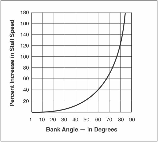

turboplanner Posted April 26, 2019 Author Posted April 26, 2019 These extracts are from the book “The Killing Zone” by Paul A. Craig Figure 4.3 is a general Load Factor Chart which complements Downunder's Foxbat Chart post #33 Note Paul Craig's disclaimer about turns other than level turns, which is complemented by BlurE's reference post $34 Once you include climbing and descending and steep, often compounding turns (i.e. turns which become sharper after entry) to follow a beast which had done a 90 degree turn, or doubled back you are well up into the top end of cropduster skills. Low Altitude Applications Bird spotting, powerline patrol, pollution monitoring, wildlife census…..have one thing in common: A pilot is on the job and that job requires attention to be paid to something on the ground. ……………They must be able to safely split their attention between flying the aircraft and doing the job……….that pilot must do two jobs at once very well. ……The pilots that do these jobs are usually not beginners. Low-Altitude – Personal Flying This category of accidents is the largest of the three maneuver accident groups. In fact 68.3% of fatal maneuvering accidents took place on what was classified as a personal flight. I would like to think that in its purest sense an “accident” is something that just happens and it is mostly beyond any person’s power to prevent. Based on that definition, the “accidents” in this category are really not accidents at all. They are deliberate acts that defy safety rules, aircraft limitations, and good old common sense. I will continue to use the word accident throughout this section but you know how I feel about them. Figure 4.1 illustrates all the maneuvering accidents that took place from 1983 through 2000. The accidents are plotted against the flight hours of experience the pilot had when the accident took place. These are all the accidents together, so fatal – as well as those with serious injury, and even a few with no injury – are mixed in. You can see the pattern that has been present in past evaluations of flight experience data. There is a zone where most accidents occur. The span of experience from 50 to 150 hours is “off the chart”. Avoiding low-altitude steep turns and low aerobatics all together is the safest course of action. But what is it about these maneuvers that become deadly at low altitude? Why does the airplane seem to fall out from under a pilot when in these maneuvers? The airplane’s wings must provide life to counteract all “down” forces. Weight or gravity is the “down” force that we easily understand, but while flying other forces come into play. These additional forces can team up with gravity and reduce the effectiveness of lift. Figure 4.2 illustrates two airplanes in flight. The airplane on the left is flying straight and level. The lift exactly opposes weight. These lift and weight vectors are fairly simple, but things get complicated when the airplane turns. The airplane on the right is in a medium bank turn. The first problem is that the lift vector is now leaned over, in the turn. Between the two airplane diagrams is a comparison of the “effective” lift. You can see that when the lift vector is leaned over, we lose effective lift because the lift vector no longer opposed weight. So in a turn we lose lift. Meanwhile, the turn will produce centrifugal force, This is the swaying force you feel in your car when you take a fast turn. Centrifugal forces join forces with gravity to form a residual load. This is more commonly called the G force. The actual force of the earth’s gravity does not get stronger when you turn, but when you add gravity and centrifugal force together it places an extra load on the wings. From the wing’s point of view it is being asked to carry a greater load. The wing is being asked to carry a greater load at the exact moment when lift is reduced and the wing is less able to carry a greater load. Something has to give. The accelerated stall takes place. Ordinarily the stall speeds are painted on the airspeed indicator. The slow end of the white arc is the stall speed with flaps down and the slow end of the green arc is the stall speed with the flaps up. But in a turn the colors of the airspeed indicator can no longer be trusted. The airplane can and will stall even though the airspeed is well within the green arc. It stalls faster than the indicator says it should and that’s why it’s called an accelerated stall. Figure 4.3 is a chart of the load factors. You can see that at shallow banks, the G force is not much above 1G. But when a pilot makes a 60 degree level turn, the G force jumps to 2Gs. That means a 2000 pound airplane now effectively weights 4000 pounds in the turn. More importantly the wings must support 4000 pounds. That is a great deal to ask – to get 4000 pounds of lift from the wings of a 2000 pound airplane. The wings probably will not be able to do it and lift is lost, the airplane stalls. 1
facthunter Posted April 27, 2019 Posted April 27, 2019 The average busy pilot won't be looking at the airspeed indicator in many situations. Bear in mind the stall occurrence is a wing's angle to the relative airflow thing, NOT it's speed and the elevator control is what will change the wing's AoA. The pilot will bring on the stall and pulling the stick back in an emergency is a natural response same as raising the nose to stretch a glide. A 90 degree balanced turn is impossible as the lift needed is infinite but you can bank to vertical and beyond with everything centred in other maneuvers like barrell rolls and loops.. The stall warning (audible) is a useful tool if you know the margin it's set above the stall speed. It's usually conservative and may be 9 knots but once it's actuated you don't know the margin unless it's going on and off constantly.. The statistics definitely show the lethal nature of flying near the stall boundary. I say again the commonly accepted method of "dealing with " stall training is ineffective and totally inadequate to what a pilot may well have happen to him/her in a real life situation. We can and must do better in this area. Nev 1 1

Downunder Posted April 27, 2019 Posted April 27, 2019 Figure 4.3 is a general Load Factor Chart which complements Downunder's Foxbat Chart post #33 Just to be clear for anyone reading this thread, it is just a generic chart and not Foxbat specific. 1
