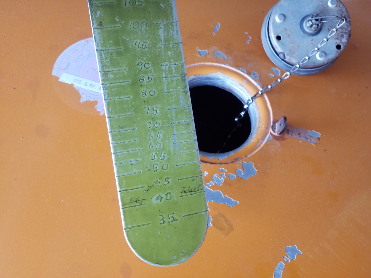

Thruster88 Posted April 18, 2019 Posted April 18, 2019 First day back for a Cessna 172 and this happens https://www.atsb.gov.au/publications/investigation_reports/2018/aair/ao-2018-005/ I sympathise for the pilot. If casa was to introduce just one more rule it should be that all old or new aircraft with crap fuel gauges must have a dip stick calibrated in litres, the repeatability of this simple piece of aluminium is truly amazing. 1
kgwilson Posted April 18, 2019 Posted April 18, 2019 I never rely on fuel gauges. Fuel tanks in wings are very wide and shallow so any slight parking angle will give erroneous results even on the dipstick let alone the gauge. I set my fuel sender float arm length according to the VDO manual for the depth of my main tank when I installed it. All well & good but the gauge read is based on the linear value provided by the float position. The problem is that most fuel tanks are not perfect cubes or rectangles so the reading will only be perfectly accurate at empty and full. This is why you should have a placard with the actual fuel amounts and the gauge reading on the panel. When you are flying it isn't much use having the placard in the manual as it was in this case. I also sympathise with the pilot as he would have got back if he had 182 litres on board instead of 144. The only issue was that he'd have used about half of his reserve getting back. As he was using a higher power setting than normal running in the engine at 2500rpm fuel consumption would have been higher than at a standard cruise of around 2350rpm. At that rpm he would most likely have got back with 144 litres and with 182 litres with the 45 minute reserve intact Now of course the reserve has been lowered to 30 minutes & the controversial Fuel Mayday introduced. Stupid rule IMHO. I still stick with the 45 min reserve.
