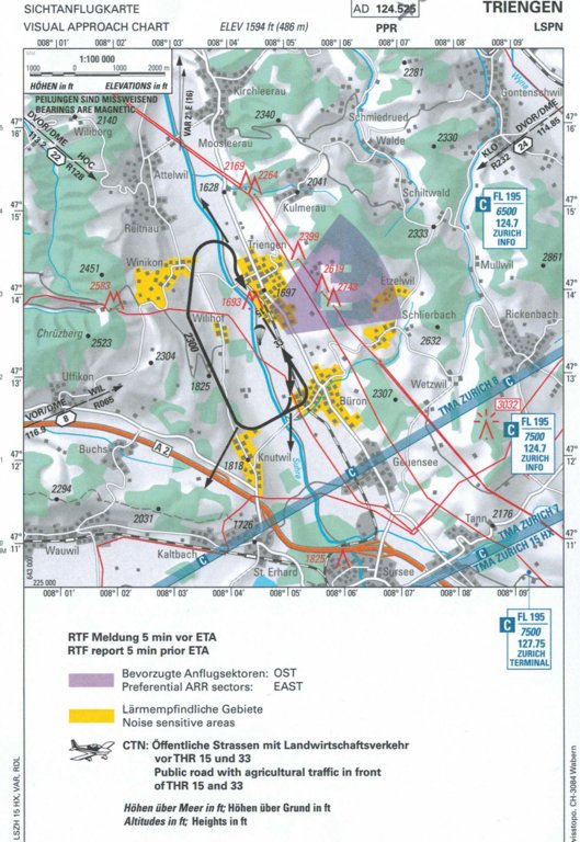

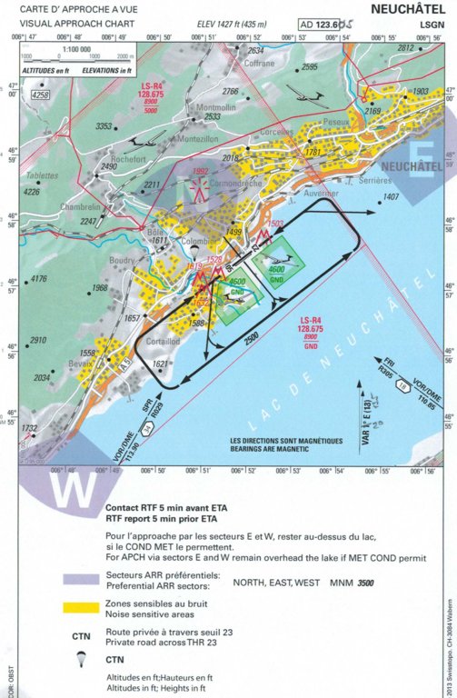

Sam the Swiss Posted May 2, 2019 Author Posted May 2, 2019 The discussion is very interesting to me. Even if Swiss procedures may diverge from that of other countries, the reasons behind the procedures all lead to the same safety problems. Maybe I can include two excerpts of VAC of two Swiss airfields, one where the close encounter happened (Triengen) and one which suggests – after my reading – to descend from overhead to downwind, because of a restricted area close by (could also be a noise sensitive ares, or high terrain in other cases). Those picture are not from me, they are excerpts of Swisstopo and of Skyguide Switzerland, I use them here solely for safety reasons.
