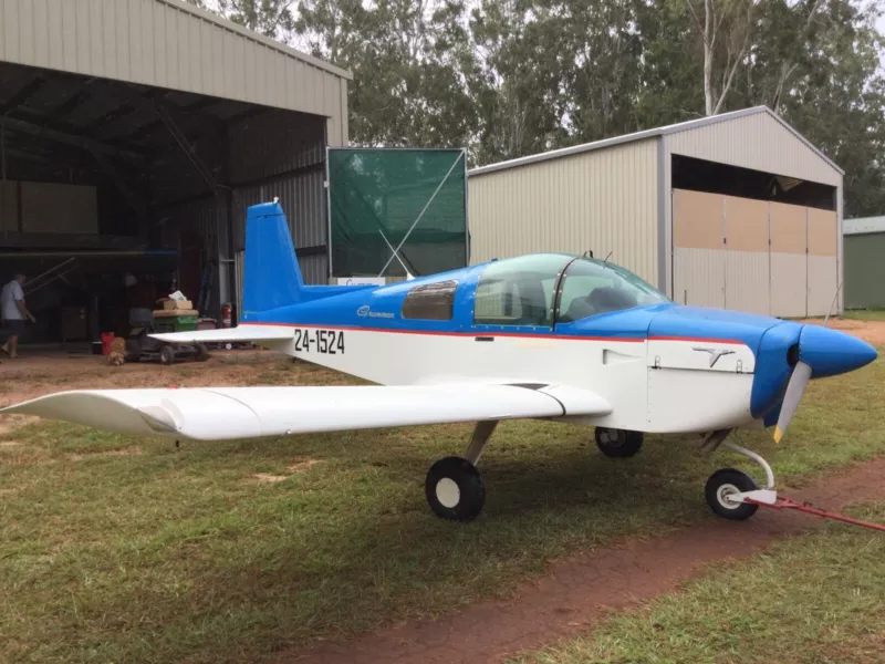

fly_tornado Posted April 29, 2019 Posted April 29, 2019 the empty weight on a Grunman is 460Kgs Specifications (AA-1A) Data from The American Trainer Owner's Manual[8] General characteristics Crew: one pilot Capacity: one passenger Length: 19.24 ft (5.87 m) Wingspan: 24.46 ft (7.46 m) Height: 6.80 ft (2.07 m) Wing area: 98 ft² (9.11 m²) Empty weight: 1,018 lb (461 kg) Max. takeoff weight: 1,500 lb (680 kg) Powerplant: 1 × Lycoming O-235-C2C flat-four engine, 108 hp (80.6 kW)
kasper Posted April 29, 2019 Posted April 29, 2019 I suppose - being generous - it’s had one seatbelt removed and a placard added single occupant only and 600kg mtow with corresponding changes to the ops handbook on all load charts etc That would satisfy the requirements ... if I squint in a dark room whilst crossing my fingers. If not then .... hmmmmm 2

Downunder Posted April 29, 2019 Posted April 29, 2019 As long as the Grumman is flown within RAA requirements I don't really care. Single seat, 460 + 80kg pilot is 540kg. Leaves 60 kg fuel (80 odd litres) for an all up 600kg. Not bad... When you look at some of the older registered european 450/520/540 kg ultralight aircraft, it's not that much different and plenty of them are 2 seaters. Many pilots are "ctaf pilots", and just enjoy a solo morning or afternoon local flight. I don't hold that against them... 3 1

408059 Posted May 1, 2019 Posted May 1, 2019 Slightly off topic. I had a Cassutt Racer that I wanted to put on the RAA Register. Steve Bell, from RAA, was happy to consider the proposition until I mentioned the 58 knot stall speed. I researched and found someone over in the USA that had brought the stall speed down to 45 knots by putting wing tip extensions on and reducing weight. While the CofG was fine he found the aircraft uncontrollable at speeds just above the stall speed. The Cassutt Racer has small tail feathers and at that speed the elevator and rudder simply did not work well. Even if you can get the weight down on 24-1524, and the CofG sorted so you have a 45 knot stall speed, there still may be problems. 3
