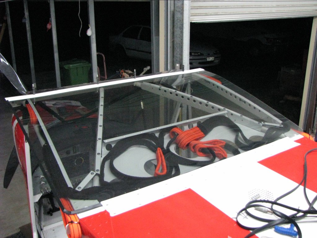

Kyle Communications Posted May 21, 2019 Posted May 21, 2019 Mine has been on the girlfriend for more than 7 years and is as perfect today as it was when I got it done. I went to a car tinting place and asked for the highest quality UV blocking film that was not too dark. I took the overhead to them flat and they applied it. Not a bubble or crease then and still not today..cost me about $70 if I remember correctly. Couldnt tell you what brand though

Kyle Communications Posted May 21, 2019 Posted May 21, 2019 here is a pic of it when it was done 7 years ago..I think it also maybe the quality of the film used and also that it is applied properly
IBob Posted May 21, 2019 Author Posted May 21, 2019 It certainly looks good. It seems to me that if the Lexan does gas, there will be bubbles regardless of the quality of the film and it's application. Maybe the gassing depends on how long since the Lexan was manufactured....perhaps...??? And to change the subject just for a moment: I thought it went on after the wings...though I see it's not fastened at the front...?

Kyle Communications Posted May 22, 2019 Posted May 22, 2019 My aircraft is always hangared so doesnt spend long periods out in the sun. Maybe this is why it is still pristine and no bubbles. I think if your aircraft is hangared then it wont be a issue to tint it
