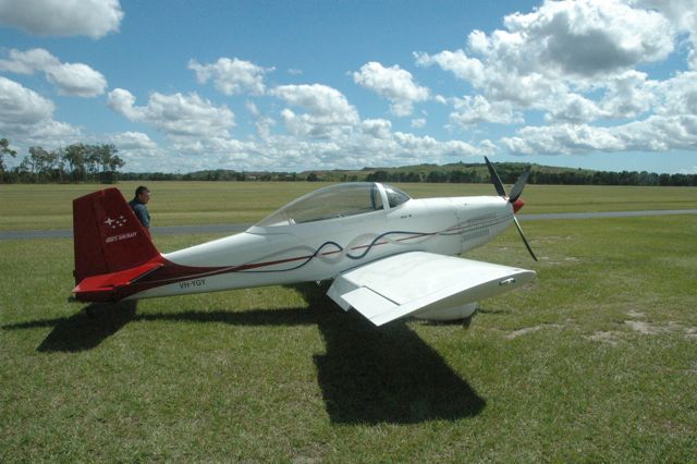

Kyle Communications Posted February 26, 2011 Posted February 26, 2011 I had a flight today in a RV8 at Caboolture and wow what a nice aircraft...really fast too we were doing 160knots TAS. Trevor has wigwag fitted to its lights and I asked him this morning what he though of them after reading this thread yesterday and he told me many many pilots have commented on how well his aircraft stands out now certainly on approach . he told me it cost him $88.00 and was easy to fit into his existing lights it also has some special current monitoring for fast switching. Seems like a good idea for all aircraft to me Here are some pics of the flight...it was awesome :) [ATTACH]11014[/ATTACH] [ATTACH]11015[/ATTACH] [ATTACH]11016[/ATTACH] [ATTACH]11017[/ATTACH] [ATTACH]11018[/ATTACH]
