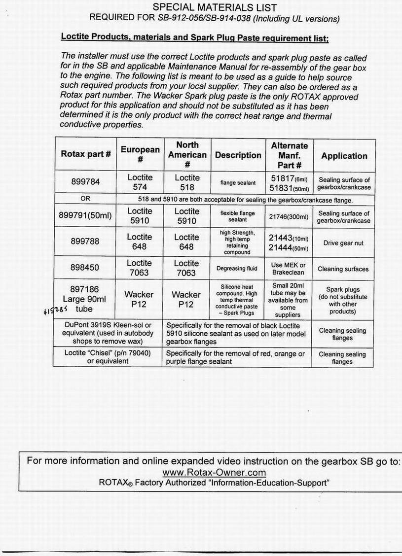

WestCoast Posted February 9, 2008 Author Posted February 9, 2008 I agree with you don,what is all this yap about heat sink compounds on spark plugs.Are you trying to soak heat from the plugs to the heads or from the heads to the plugs?The paste that should be used on the plugs (sparingly) is to minimize pickup of the aluminiumthreads by the plugs when screwing the plugs out.It should be an anti sieze compound. Jabiru specify Nickel Sieze. Nelson...I started this thread (Spark Plug Heat Paste for Rotax engines ) as Rotax are very specific on the subject and I was interested to learn what others were using. Below is some documentation from Rotax and you will see what I mean:-
Guest Nelson Smith Posted February 9, 2008 Posted February 9, 2008 Yes Westcoast I see what you mean. Thanks Nelson
