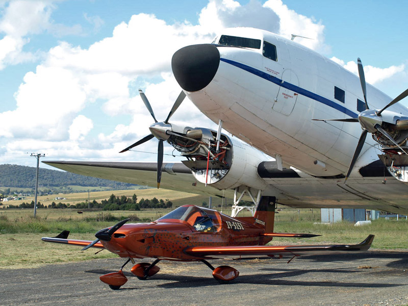

Thruster87 Posted February 6, 2008 Posted February 6, 2008 [Soon A C150 may be the same as a DC3. you can pick them up for a song but your 100 hourlies will kick the crap out of you..] LOOKY HERE!!!!! the DC3/C47s are around 60yrs OLD and are still flying with VERY little corrosion on our two at HARS.They where made in a hurry during the war years but they where primed with zinc chromate and it has made all the difference. Cheers T87
slartibartfast Posted February 6, 2008 Posted February 6, 2008 Like this one. [ATTACH]4911.vB[/ATTACH] She arrived from South Africa some time ago and has been sitting around at Goulburn in the elements for ages. Now she's getting a little engine work and will soon be winging her way to Bankstown for the next stage of her life. Great to see.
