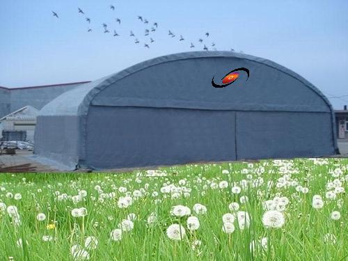

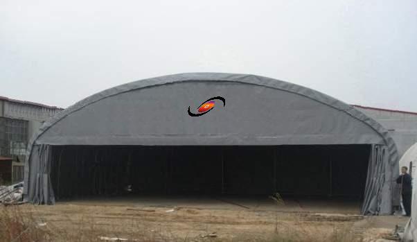

Do you think these would be worth investigating further to bring into Australia and if so how much would they sell for here - in your opinion
1. Size: L9.15xW14.0xH4.8m
2. Frame: Galvanized Trussed Steel Frame:
3. Cover: 600g/m2 PVC tarp, grey or white
4. A sliding door in the front panel, size: W12xH2.25m
5. Gross/net weight: 1440/1270kgs
