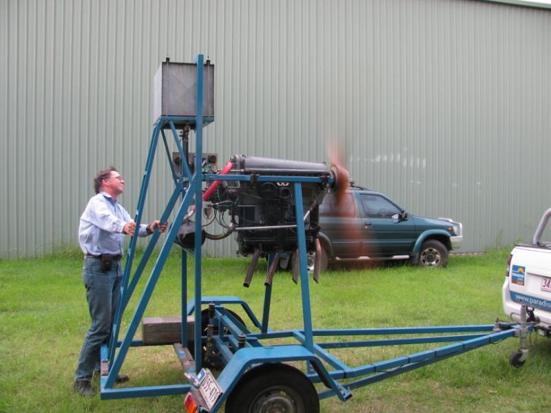

Brother met me at the airport and we proceeded direct to Archerfield where the engine was already bolted to a test stand. We spent the rest of the morning connecting up oil and fuel lines, priming the oil pump, checking ignition wiring, checking tappets and ignition timing, filling the rocker hats, removing the exhaust blanks and filing and fitting a motley selection of exhaust stacks. Eventually all seemed ready, everything was double checked (especially the magneto connections- don't want to be in a situation were it starts and then can't be stopped!) and we were ready to fire it up. Fuel on, prime (four blades forward), throttle wide, blow out (eight blades backwards), close and set the throttle, contact! It coughed on the first swing, the second swing, the third swing and the fourth swing, blowing a cloud of blue smoke each time (inhibiting oil). With all the cylinders thereby cleared, it fired on the fifth attempt and ran smoothly, with the oil pressure climbing to a good level within a few seconds. (Not bad for an engine that was overhauled 12 years ago and has been in storage ever since). After a few minutes to warm it up we checked magneto drop, and oil pressure at varying revs, then gave it a burst at full throttle to check static rpm. All the numbers were as they should be and the engine scarcely missed a beat. My brother, who took this photo, reckoned I looked like a parachutist when the engine was at full power- with rippling cheeks and all. That prop certainly shifts some air!
[ATTACH]644.vB[/ATTACH]
We got the machine back inside just before the thunderstorms that had been building up all day let their deluge and lightning go off, and spent the rest of that day and half the next removing all the test gear and mounting and packing the engine ready for transport.
