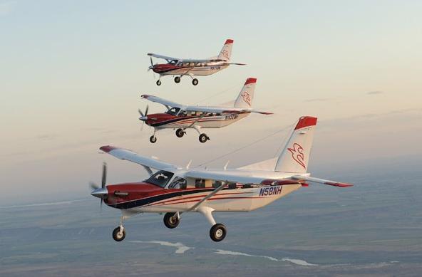

It looks like the 10-seat turbo-prop GA10 has been trumped by a machine that looks like a baby Cessna Caravan, called the Quest Kodiak. This is by no means a new aircraft, having first flown in October 2004. Over 50 had been produced by May 2011, with the major user being the Missionary Aviation Fellowship, which uses them in Borneo and Haiti, among other places. The first (and so far only) example in Australia was registered in Nov 2011.
From specs on both manufacturers websites, it appears that the Kodiak trumps the GA10 in most other aspects as well:
......................................................GA10.............. Kodiak
MTOW ...........................................4450 lb ............7255 lb
Max Cruise Range .............................750 nm ..........1005 nm
T/O Ground Roll ..............................1800 ft ..............934 ft
Cruise Speed ....................................150 kts ............185 kts
ROC ...............................................1000 fpm .........1371 fpm
Seats .................................................10 ...................10
Other specs for the GA10 are not yet published.

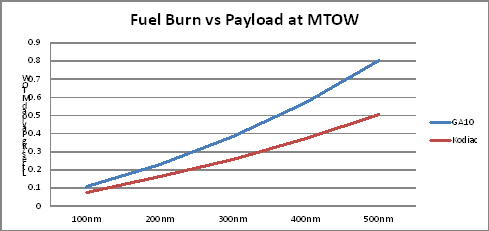

Using the magic of Excel, I can tell you that for paying passengers, the same-same point for profitability is between 300 and 350NM for these types. The maths is icky, PM me if you want a copy of the spreadsheet I used. The GA10 is more profitable for the shorter missions such as skydiving. Note I was being generous by awarding the PT6A-34 a sfc of 0.5 lbs/hp/hr. Unit on the left is litres burned per kilogram payload at MTOW.
For the brown box brigade, we have this:

I don't know what is in the spreadsheet, but you need to go far and wide to find a turboprop that has better overall economics that a PT6-34. An aeroplane that can do 1,000fpm at S/L will need a lot of flat rating to still be doing 1,000fpm at 14K which is what you are implying
