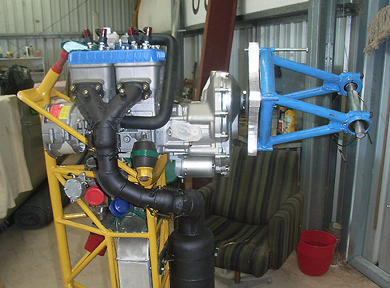

Jeez, get it right. It's a 582 Blue-Head Rotax.
[ATTACH]26801[/ATTACH]
And the Everel concept isn't 'self-feathering', it's more like a 'constant speed' prop: at high rpm the geometry reduces it to fine pitch so the thrust is maximised; when throttled back, it automatically coarsens pitch for best economy.
However, at much more than around 100 hp, other factors make the Everel concept inefficient.
But, you're right: somewhere near Toowoomba. And a Blanik. With the necessary mods. to allow it to fly. Rumour has it the bugger has several 'legal' Blaniks in his hangar, after some metal-bashing has been done to repair damage to one of them.
Well it's a Rotax with half as many strokes as a proper engine needs, but I suppose the prop has half as many blades as seems proper, so maybe it all gels.
So it's a blue head. So what? I'm married to a red head. Both can be cantankerous little things though one is more reliable than the other. and NO! I'm not going to say which is witch.
