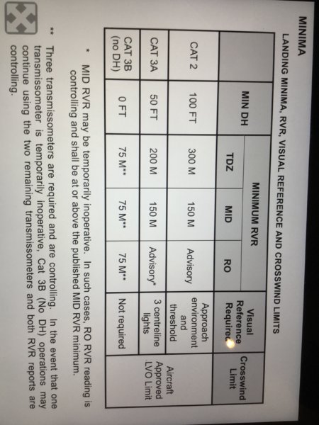

peter51 Posted July 14, 2018 Share Posted July 14, 2018 I can help with this one. I am a 737 Captain with QANTAS. Firstly the ground installation must support low vis ops. This requires mandatory standards of ILS, ground lighting and transmissometers. Transmissometers are devices that operate in pairs to measure lateral visibility accurately at the threshold, mid, and end segments of the runway. Generally only airports with high end ILS systems have these as they are required to support the low vis ops - now installed in Perth only recently. The ground systems are categorised from CAT 1 through to CAT IIIIb. Perth has recently been upgraded to CAT IIIb standards and supports Autoland with no minima and 75m visibility. Crew and aircraft have to be certified to make such approaches.The aircraft must still carry fuel for an alternate with fog and all its systems that support autoland must be serviceable - as must the ground systems. See the chart below. The various minma and required visibility are tabulated at the bottom of this chart. To utilise the lower minima the crews have to be highly trained over several Simulator sessions and given recurrent training and testing regularly every 6 months. CASA and other authorities dictate all the training requirements. Some operators may not have authority to use the lowest minima and some overseas low cost carriers may have only been given the minimum training - when you buy a ticket these days you really do get what you pay for. Of course they will say they are just as well trained as anyone else. We can use the 737 as an example. It only has a 2 axis autopilot - no rudder control on rollout - Boeing has only certified it to Autoland in CATII conditions. However QANTAS 737 aircraft have additional capabilty to land in worse conditions than CAT II - a Head Up Display which allows manually flown approach and landing to CAT IIIa minima. That means you need to see a few approach/threshold lights through the HUD at 50 feet above the ground before deciding to manually flare via flare cue in the HUD. More modern aircraft like the A330 have all the bells and whistles and can Autoland at the lowest minma CatIIIb. The pilot does not have to see anything at the minima callout to continue the Autoland in this case - however it is against the law to continue an approach below 1000 feet if the transmissometers are continuously reporting visibility below that published on the chart - unless you are out of fuel and options. So if ANY operating transmissomers were reporting below 75m then by law you would need to divert. So if you are travelling to destinations with a CATIIIa or b installation that suffer from fog in Australia - book on an Airbus i.e.Perth. However if the ILS ground installation is a standard ILS setup but has a Special Authorisation minmin E.G. Canberra, then go on a QANTAS 737 as we can go lower than all the other operators using our HUD. If you have any other questions Id be happy to answer. [ATTACH]36712[/ATTACH] Link to comment Share on other sites More sharing options...

Bennyboy320 Posted July 15, 2018 Share Posted July 15, 2018 [ATTACH]36713[/ATTACH] These days with ground radar it’s a bit easier compared to the 1960’s. We only use CAT 3B, with CAT 3C it’s basically 0/0. Link to comment Share on other sites More sharing options...
