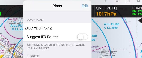

Hi All,
I cannot figure out how to get a plan started on Oz runways without it selecting me at home with a 5 mile leg to point of origin ie home to YSTW. When i tap airfield it only has option to add to plan, not start from there. Is there something i am missing. I want to print plan sheet which I can only do at home. Any tips appreciated.
thanks

Send them a question. They get a reply back quick. Great team to deal with. I have rwy on android so can't help.
Make sure it doesn’t think you are flying. Ie hit cancel near top right. Then tap the aerodrome and select set as origin of plan.
The easiest way to prepare a plan is to do it on the chart. Find the airport of departure on the chart and tap on it (if it has a little camera symbol tap near it) and select your airport as “origin” from the drop down box. Find your next intended landing point and do the same...etc.

The hit cancel worked a treat, picked my first tap as origin. Easy to do that way.
I used a trial of OZ Runways, but decided to stick with Avplan, but I had no problems making a flight plan. The instructions were clear and worked for me.
From memory it was similar to Avplan, which has a "new flightplan" button, then just pick a start point, a finish point and you can put points between.
