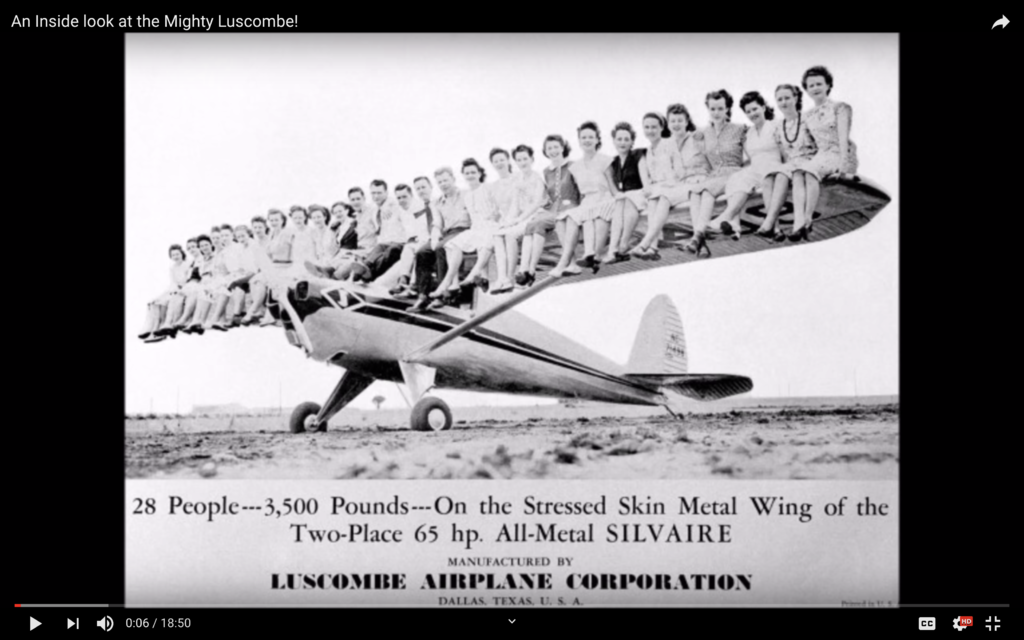

Garfly Posted July 2, 2019 Author Posted July 2, 2019 ... and/or be stingy with your sums, and/or take off into the dawn's early light, and/or leave a few of your would-be passengers behind: 2
facthunter Posted July 2, 2019 Posted July 2, 2019 It's a bit funny as the positive "G" limit is usually much higher than the negative one which is how that's loaded. Must have been a bit of an effort to get them into position. Nev
