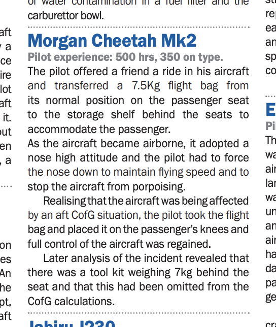

Weight and balance: A 15 kg tool box placed on the passenger side in a Morgan at one time took it out of control on takeoff and the pilot was only just able to wrestle it to the ground.
If this storied tool-kit is the same one I remember, it was actually moved from its usual place on the passenger seat
to the back parcel shelf to make way for an unexpected passenger. A scenario that makes more sense.
Typically, you might get away with a tool kit weighing 80Kg on the passenger seat without balance problems.
(Assuming you don't bring the plumber as well. ?
From Sport Pilot Aug. 2012:
Re-reading that short report I now understand that the 7Kg tool kit more or less lived behind the seats and it was the 7.5Kg flight bag that was thrown over onto the back-shelf making a total of around 15Kg in the rear station which brought the situation to its tipping point.
 It's pretty easy to recognize the warning signs for planes with  potential C of G issues. Some examples are fuel tanks  or lockers located in front of or behind the C of G range as represented on the mean  aerodynamic chord of the wing. A safe range is stipulated in the POH and is usually around  a point 1/3rd of the distance from the front towards the rear. of the  effective wing chord..
       A side by side two seater that has the fuel in the wing  is usually the least sensitive  to errors as fuel and load are near the centre of gravity, in the main. .We are looking at. "couples" where  force and distance are the factors so a small mass at a long distance can equal a large mass at a smaller distance in terms of it's turning effect about a  (pivot) point usually considered to be  the C of G for our purposes.  Your plane must balance in the allowable range with the fuel as loaded and also at landing weight and Zero fuel weight (empty). Aircraft that have a big change in CofG with fuel  load are  probably the most difficult to deal with and I find the use of graphs in the load assessment to be the most obvious to use and check the logic of. Others use  datums that may be in front of the actual plane or a convenient place on it's fore and aft axis and fixed designated distances for various Load areas like the Cof G of the pilots seat and same for fuel tanks or a locker or storage area.. Some people over time have devised some rough and ready methods  that would show an out of range condition, and that's at least recognizing there is a problem. Errors still occur in Big stuff as well so a "She'll be right"  is not appropriate. Fuel management and W&B are usually a required 100%pass for good reasons. Secure your load as well. Loads moving has killed plenty. Your plane is not airworthy when out of balance or overloaded. Nev
