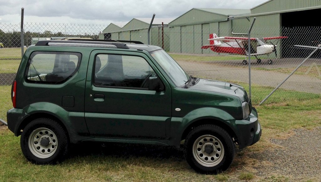

Garfly Posted August 4, 2019 Author Posted August 4, 2019 No wonder the Skyranger has been eyeing-off the Jimny ... and vice-versa. ? https://sites.google.com/site/bestultralightengine/ 2
eightyknots Posted June 1, 2020 Posted June 1, 2020 No wonder the Skyranger has been eyeing-off the Jimny ... and vice-versa. ? bestultralightengine [ATTACH alt=IMG_1650.jpeg]40209[/ATTACH] An informative article at that link!
