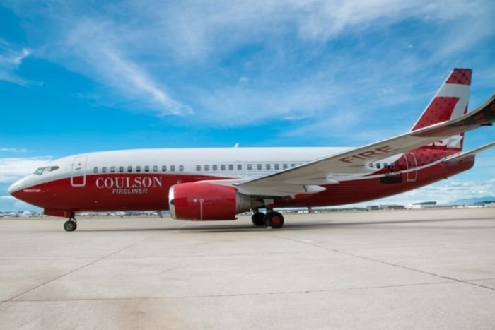

red750 Posted August 4, 2019 Posted August 4, 2019 NSW Rural Fire Service today took delivery of the first full time fire bomber flying tanker. The aircraft has been named Marie Bashir after the former NSW Governor. The aircraft carries the same colours as the photo below, but with NSW RURAL FIRE SERVICE above the windows. Coulson name removed.
