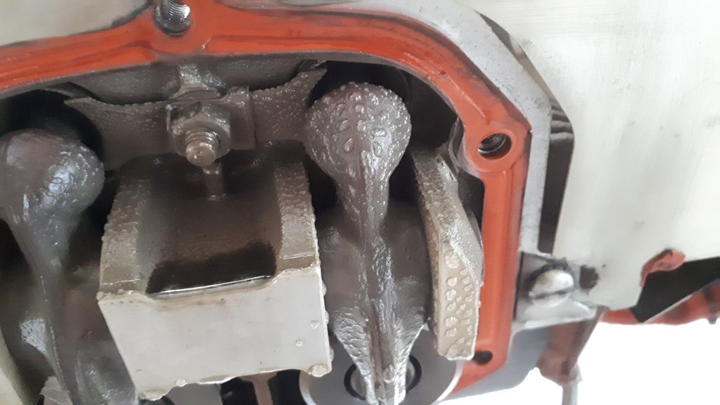

Thruster88 Posted August 8, 2019 Posted August 8, 2019 This pic was taken just after removing the rocker cover. The engine had a performance ground run 24 hours prior before a 100 hourly inspection. Yes those are water droplets, my advice, don't start your engine unless you are going flying. 1 1
kgwilson Posted August 8, 2019 Posted August 8, 2019 It takes at least 30 minutes for an engine to reach its correct operating temperature and any water vapour will take even longer to dissipate through the breather system. Short engine runs especially when humidity is high and diurnal temperature variation is also high can cause water from vapour to condense as droplets and eventually mix with oil which will become opaque and eventually quite milky. As soon as this becomes evident change the oil and your engine running habits. 1 2
facthunter Posted August 9, 2019 Posted August 9, 2019 You probably won't start to get the water out of your engine until the oil gets above 85 degrees C (where you measure it, and it will have to be hotter in other places. to do the job). The water doesn't come from the atmosphere. The hydrogen in the fuel forms water with the oxygen that burns it. (H20) How much? Petrol is CnH2n+2 = C8 H18 atomic weight total 96+18 = 114 the hydrogen H18 plus O 10 has an atomic wt total of 18+120 =140 so you get a larger wt of water than petrol as a result 70/57. the water in the engine comes from burning the fuel, and there's plenty of it. . Most goes out the exhaust but some goes past the rings or your exhaust valve guides. It's also got nasties from the fuel additives and impurities often forming acids. Just imagine IF that engine had not been run for a month or so afterwards It would be a corroding mess invisible to your eyes. People fly a bit and leave their precious plane in front of the clubhouse and as the sun sets, fire it up and taxi to the hangar. Get the picture? They also give it a good 10 minute run with a few revs on, every 3 or 6 weeks. That's probably doing more harm than good.. No wonder some of this stuff plays up. Nev 1

Thruster88 Posted August 11, 2019 Author Posted August 11, 2019 The water in that rocker cover would be from the atmosphere Why do we never find water when we pull wing inspection panels on metal aircraft in similar winter weather?
turboplanner Posted August 12, 2019 Posted August 12, 2019 Why do we never find water when we pull wing inspection panels on metal aircraft in similar winter weather? I don't know but from my experience with refrigerated vans hot travels to cold, and if the skin is impervious water droplets build up on the outside skin. Air isn't going through the skin, so I'm not sure how this water is being extracted.
facthunter Posted August 12, 2019 Posted August 12, 2019 The surface is below the dew point of the air in contact with it. Jetliners after landing may still show frost on areas where the fuel is still cold .They may have been cruising in temps of minus 58 degrees C. Nev 1
