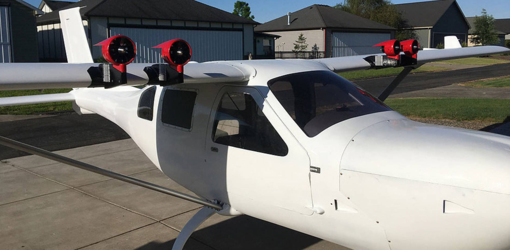

Bruce Tuncks Posted August 22, 2019 Posted August 22, 2019 He thinks the reader doesn't understand power and energy. 50kW is a rate of energy consumption. It tells you nothing about how much energy you need. Like saying how you live only 50 km/hr from the city. But the Jabiru is interesting... I wonder about the placing of the ducted fans , they look to be too few and not spaced properly. And I would think that a "blown" wing would be quite a specialized airfoil with a built-in duct system. I imagine a pipe inside the leading edge with a slot at about 5% chord blowing air back over the upper surface. Thanks for the info Turbs. 1
Bruce Tuncks Posted August 22, 2019 Posted August 22, 2019 There is a good story " NASA remakes the airplane wing with a whole lot of propellers". They are modifying a Technam to a blown wing with 12 electric motors on the leading edge.
