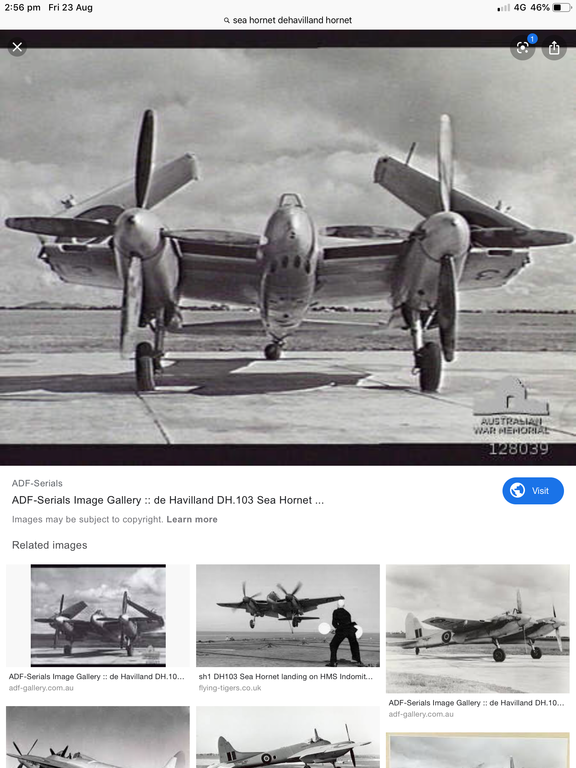

skippydiesel Posted August 23, 2019 Posted August 23, 2019 I thought Merlines did come in CR variants - did not the DH Hornet have "handed" engines for carrier ops ??
derekliston Posted August 23, 2019 Posted August 23, 2019 I thought Merlines did come in CR variants - did not the DH Hornet have "handed" engines for carrier ops ?? Don’t know, I will check, thus far I haven’t been able to find other than ‘American’ clockwise viewed from the cockpit. I think the British ones going ACW was a left over from the days of hand swinging props.
derekliston Posted August 23, 2019 Posted August 23, 2019 Don’t know, I will check, thus far I haven’t been able to find other than ‘American’ clockwise viewed from the cockpit. I think the British ones going ACW was a left over from the days of hand swinging props. Checked such photographs as I could find and you are correct. They must have been in the minority!
facthunter Posted August 23, 2019 Author Posted August 23, 2019 It is more efficient and you don't have a "critical" engine. Both engines have the same VMC(a). For "normal" operators it means more spares must be available for two engines and props where they vary, so many don't do the option. Nev
skippydiesel Posted August 23, 2019 Posted August 23, 2019 To add to Nev's observation - From my reading, it would appear that having CR engines for carrier opps makes the pilot workload less. I only have a single engine rating, so with no experience, speculation and low tech understanding, I understand this to mean that the aircraft will not swing on take off as the DH Hornets predecessor (DH Mosquito with out handed engines) was supposed to do.
