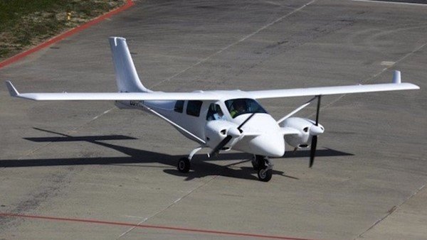

Bruce Tuncks Posted August 24, 2019 Posted August 24, 2019 I guess this aircraft is flying ok in South Africa. Would it be illegal in Australia? Is it possible that the much smaller CASA equivalent in South Africa is actually an advantage for them to pursue advances without the dead hand of bureaucracy holding them back?
turboplanner Posted August 24, 2019 Posted August 24, 2019 I guess this aircraft is flying ok in South Africa. Would it be illegal in Australia? Is it possible that the much smaller CASA equivalent in South Africa is actually an advantage for them to pursue advances without the dead hand of bureaucracy holding them back? There is nothing to stop you joining SAA and designing and building one from Jabiru parts like the South Africans. There's no dead hand holding people back in Australia, with many very interesting approved aircraft flying around. 1
Tasmag Posted August 25, 2019 Posted August 25, 2019 Jamie at jabiru is flying a 430 twin, has been for a while. 1

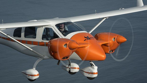

red750 Posted August 25, 2019 Posted August 25, 2019 Someone stated - redefining Ugly. With an orange nose and engines it is. 2
Deskpilot Posted August 25, 2019 Posted August 25, 2019 Simple answer is, of course it would......but not under RAA certification.
440032 Posted August 25, 2019 Posted August 25, 2019 There is a low winged Jabiru 230 being built somewhere, Victoria I think.... with some fancy auto engine conversion. 1
Bruce Tuncks Posted August 25, 2019 Author Posted August 25, 2019 Thanks guys, that's all good news. Maybe I have a too-negative attitude towards CASA. There is a sailplane manufacturer in South Africa ( Jonkers ) which make top-class sailplanes, as good as the Germans, and for years I wondered if they operate over there under an easier regulatory system. Their home market is small and they are a long way from supplies, so how come those south africans are doing so well?
turboplanner Posted August 25, 2019 Posted August 25, 2019 Thanks guys, that's all good news. Maybe I have a too-negative attitude towards CASA. There is a sailplane manufacturer in South Africa ( Jonkers ) which make top-class sailplanes, as good as the Germans, and for years I wondered if they operate over there under an easier regulatory system. Their home market is small and they are a long way from supplies, so how come those south africans are doing so well? If you go back to AUF history we probably did better, but we lost some of our most talented designers. They have had their losses too, but are great innovators like us and NZ.
Jaba-who Posted August 29, 2019 Posted August 29, 2019 No one is making them to sell. Not here in Oz or in South Africa. I’ve been keeping an eye on the happenings because I’m pretty keen to get one when they become available. Jabiru In South Africa have the most experience and still trying to sort out issues with vibrations. Stiffy has told me to hang in there for a while yet. As stated there is nothing stopping anyone with a amateur build VH 230 or 430 pulling it apart and making a twin now but they would be on their own - Jabiru wouldn’t back them up and it would require a AP to approve the new special Cof A and no AP would be that silly while Jabiru themselves say no. 1
