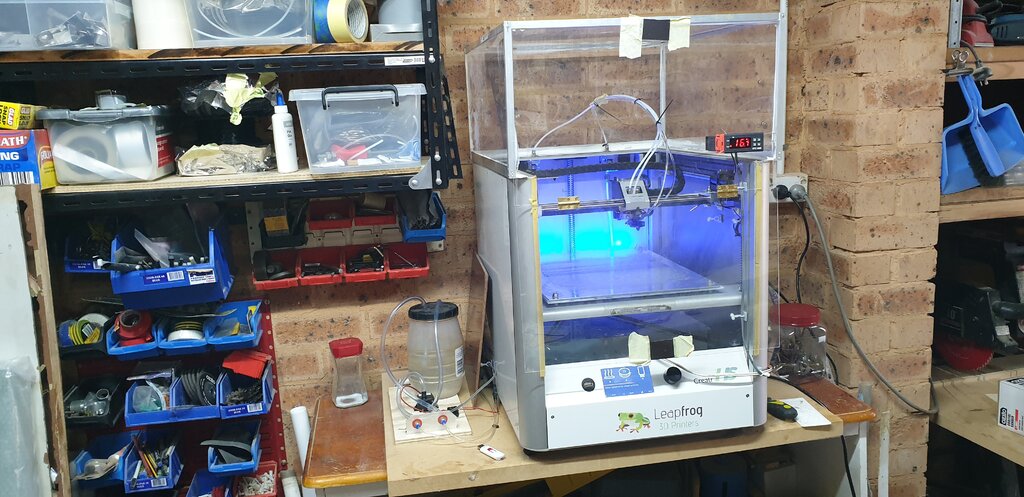

Geoff_H Posted September 14, 2019 Posted September 14, 2019 I have designed my aircraft to use 3d printed parts for all load bearing parts except where elevated temperatures are involved. I have used AutoCAD to design the parts. I bought a Leapfrog Create HS. I paid $2.5k when the dollar was much higher, the printer has some serious problems when one tries to print nylon. All bushes in my aircraft are nylon, all load bearing parts are nylon impregnated with carbon. The design of these parts is very different to the conventional steel parts. They are built a but like internal house doors, a honeycomb on the inside and a thin shell on the outside. Nylon and carbon impregnated nylon are around one sixth the weight of Steel, half that of aluminium. I have had to modify the printer that I bought, it now has water cooled nozzles, an aluminium print bed, special nozzle feed (I have developed a nozzle capable of temperatures of hundreds of degrees centigrade) I print at 265 degree Celsius. I have built a temperature controlled enclosure. I am printing the wheel hubs, Azusa injection mould their wheels using the carbon impregnated nylon. They work well. I impact test each print, every now and then I get a layer that didn't weld to the layer below, once because I opened the enclosure to have a detailed look while printing. The parts have been conservatively designed. The purpose of the aircraft is to confirm that a lighter aircraft can be built by this method. I am thinking about designing the flaps using the 3d printer. Experiments with nylon alone showed them to be the same weight as fibreglass flaps and not nearly as rigid. 1

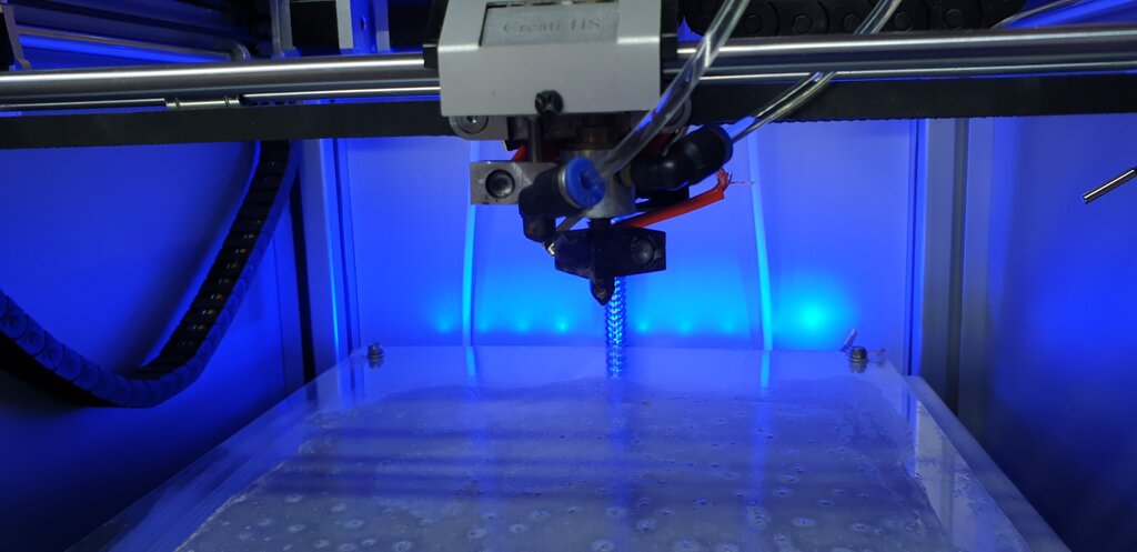

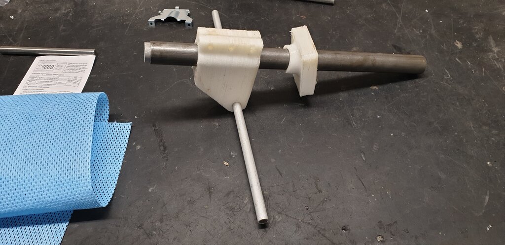

Geoff_H Posted September 15, 2019 Posted September 15, 2019 Pictures show printer with water cooler left. Also the water cooled nozzle and some nylon parts manufactured.

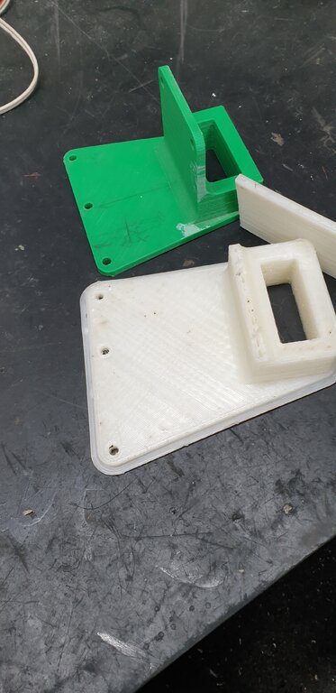

Geoff_H Posted September 15, 2019 Posted September 15, 2019 Landing gear support. Green is proof of design, it was too small and was increased. White part should have been a straight nylon part, it failed impact testing 1

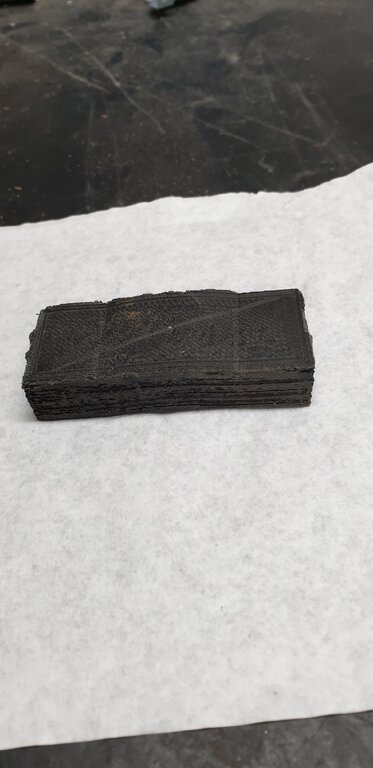

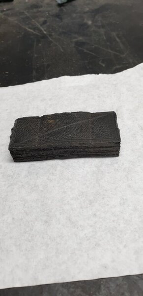

Geoff_H Posted September 28, 2019 Posted September 28, 2019 This part was 3d printed. A test piece. Each end was bent to 12 mm deformation. It maintained its integrity. More interesting it returned to near its original Shope over the next few minutes. It is very tough, it didn't delaminate. This is so encouraging for the future of 3d printed parts. It weighs 13grams. Is 65x25x12. Carbon infused nylon.
