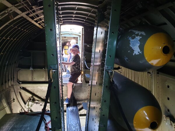

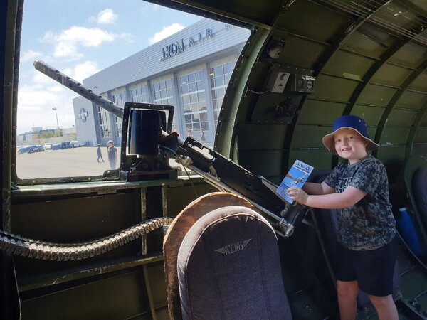

BackcountryAeropup Posted October 4, 2019 Author Posted October 4, 2019 Lucky to have looked threw one at the lyon's air museum when they had a open day in may.

BackcountryAeropup Posted October 6, 2019 Author Posted October 6, 2019 Unbelievable. The B17 my son and I was looking through in may this year at the lyon's air museum open day was 909.
