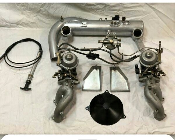

Davidnane Posted October 11, 2019 Author Posted October 11, 2019 airbox attached to turbochargers from one side and other is attached to carburetor. this is used for increased the boost pressure.

Thruster88 Posted October 11, 2019 Posted October 11, 2019 airbox attached to turbochargers from one side and other is attached to carburetor. this is used for increased the boost pressure. [ATTACH]41697[/ATTACH] There would be an increase in temperature due to the turbo compressing the air, this is why most turbo engines have inter coolers. Check with rotax for spec. 1
Downunder Posted October 12, 2019 Posted October 12, 2019 At 12 to 16000 ft OAT is going to be pretty cold but the turbo is going to be working hard compressing air to sea level oxygen levels so I don't really know if this temp is normal or not. You will get the best answer from the "Rotax Owners" forum. There are a number of sensors on these engines to control boost limits. I imagine air inlet temp is one of them. 1
