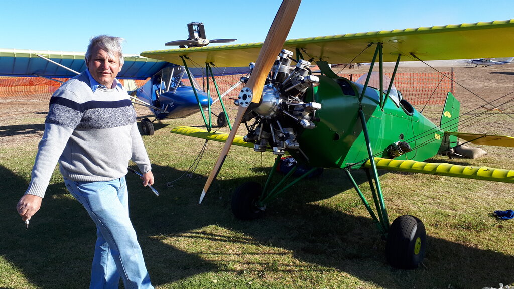

Thruster88 Posted October 23, 2019 Share Posted October 23, 2019 For example, if I had my druthers, I'd love to build a little biplane called the Gere Sport Biplane, a 1930's tube and rag plane. However, I want to use aluminium tubing instead of steel to make the airframe in a similar way to the Morgan types. I'd also make the wing spars from aluminium. Obviously, such a step away from the original would require testing and the input of experienced builders of aluminium airframe aircraft. My friend Dave with his amazing Gere Sport. This aircraft is very special because of the back story of how his father acquired the plan and many years later they built it together true to the original materials and methods. It has been flying for 15 years now. 2 Link to comment Share on other sites More sharing options...
old man emu Posted October 24, 2019 Share Posted October 24, 2019 My friend Dave with his amazing Gere Sport. Looks like the Gere would fit a bloke of my ample proportions. How serviceable has that Rotec radial been? Link to comment Share on other sites More sharing options...

Thruster88 Posted October 24, 2019 Share Posted October 24, 2019 Looks like the Gere would fit a bloke of my ample proportions. How serviceable has that Rotec radial been? Dave is not a big guy, some of the Gere appeal to me is it's small size, remember designed 1931. About 300hrs no issues. Link to comment Share on other sites More sharing options...
Methusala Posted October 24, 2019 Share Posted October 24, 2019 Dave is not a big guy, some of the Gere appeal to me is it's small size, remember designed 1931. About 300hrs no issues. I remember seeing this great aircraft at a Tumut BBQ. It is a tribute to the builder and a joy for the pilot. Rarely does one see such impeccable workmanship. 1 1 Link to comment Share on other sites More sharing options...
