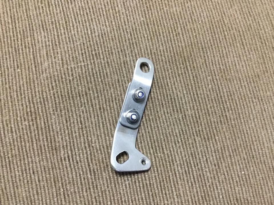

Kyle Communications Posted October 29, 2019 Posted October 29, 2019 We have been doing a lot of work on these issue. The throttle arms are not exactly the same in travel the way some of the throttle cables are setup this causes uneven mixtures. Solved by making extra arm fitted to one of the carbs and measuring the openings by adjusting the length of the arms to suit the throat opening. The larger cross tube made and fitted on several engines now and a much bigger improvement to burn pattern and idle and cruise smoothness. I think Rotax do not want to change anything because of all the extra paperwork for certification this is why. No different than when they made the new IS engine and changed the oil pump to a 6 lobe pump instead of keeping the original 4 lobe and they also changed the oil pressure relief valve design...because it was a new engine they did this as the was no extra cost. They fixed their mistakes without any extra real cost 1

Kyle Communications Posted October 30, 2019 Posted October 30, 2019 Measure the length of travel of the throttle lever if its out just make a extension for one then you can even up the travel of the butterfly Doing the 19mm tube mod also bought all 4 EGT to almost exactly the same where before 2 were more than 80deg higher than the others now they have come back to the same. The engine idles better and runs smoother The mcFarlane twin cable throttle lever is the best around but really needs to be mounted in the centre of the dash not off to one side. But its a lot better than the savannah setup which has too much flex in the mounting plate and too much difference in cable lengths
