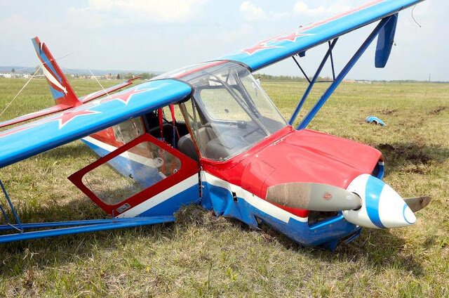

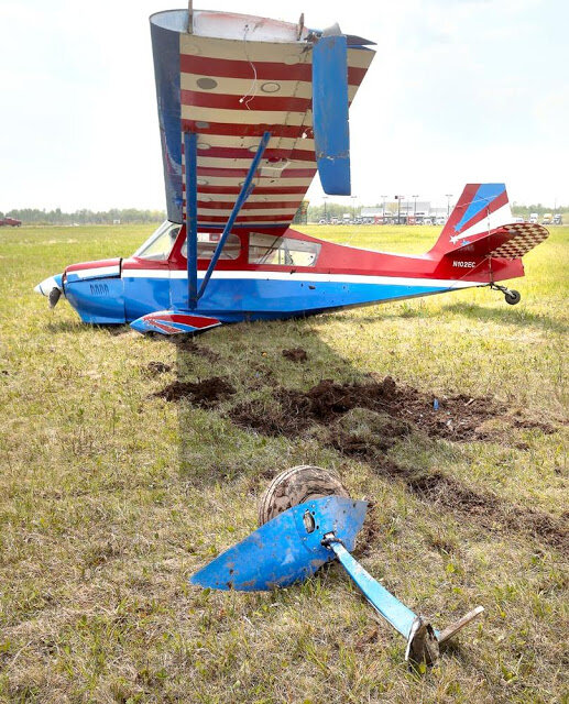

Guest deanfi Posted November 9, 2019 Posted November 9, 2019 This is old but posting to remind the importance of accounting for all you gear when leaving the aircraft , a 9 volt battery brought down this Decathlon. http://www.kathrynsreport.com/2015/05/bellanca-8kcab-decathlon-n102ec.html

facthunter Posted November 10, 2019 Posted November 10, 2019 That plane actually survived that "ARRIVAL" quite well in the struts and wing department as well as all bar the lower front of the fuselage. She will fly again no doubt.. Restores my faith in them somewhat. Not a bad jigger to own. I admit to a slight bias, but you definately could do worse. Nev
