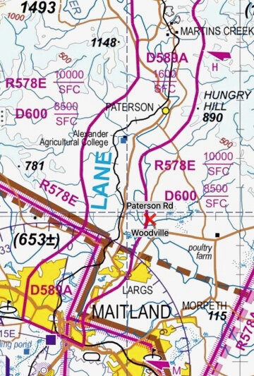

turboplanner Posted December 2, 2019 Posted December 2, 2019 'JG3 said: This conversation has really drifted.... The lane issue should to be moved to it's own heading elsewhere in the forum, and kept alive because it is important. The aircraft came down near Paterson Lane, Woodville which looks very close to the lane, so the lane issue should stay in until that is verified. Also the weather forecast at the time.

turboplanner Posted December 2, 2019 Posted December 2, 2019 Can anyone confirm (a) Paterson Rd, Woodville is within the VFR Lane (looks like it is on the maps I looked at.? (b) A SIGMET for severe turbulence was active at the time (Sat 30/11) about 12:00?

Garfly Posted December 2, 2019 Posted December 2, 2019 [Edit to my previous post.] That location appears to be right on the eastern edge of the lane.
Garfly Posted December 2, 2019 Posted December 2, 2019 This is not meant to mark the accident site, just one point on Paterson Rd. Woodville.

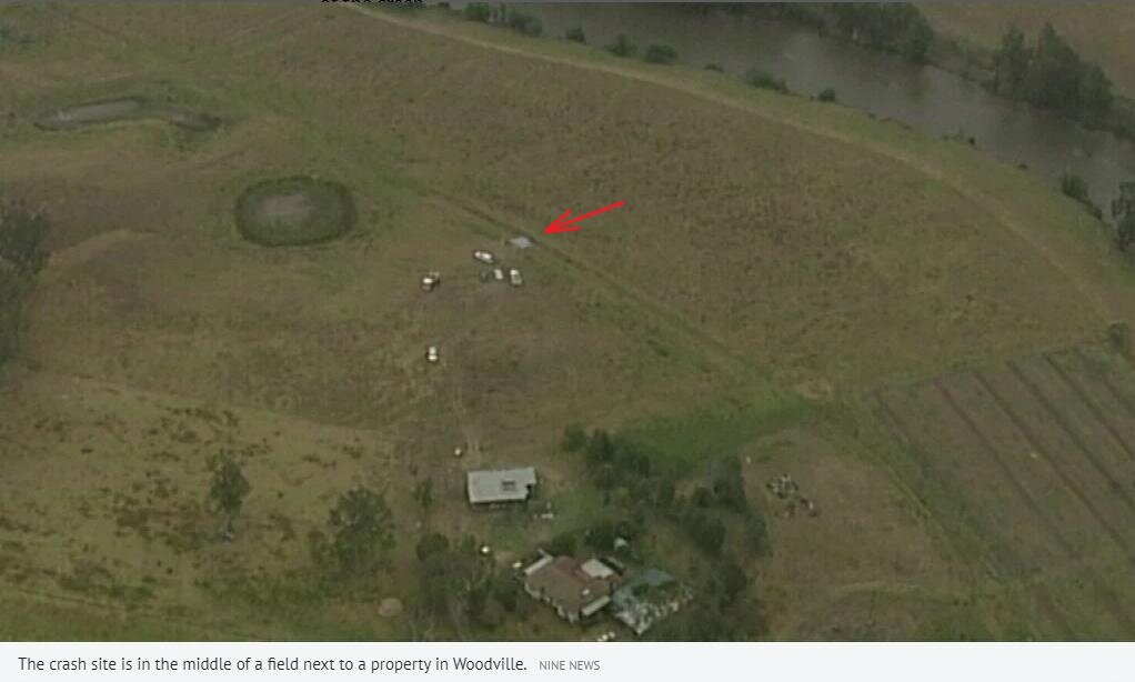

onetrack Posted December 3, 2019 Posted December 3, 2019 The actual crash site of the trike is marked on the Google Maps link below. I found it by comparing features in the media chopper photos, to actual features on the map. https://www.google.com/maps/place/32%C2%B039'24.3%22S+151%C2%B035'43.1%22E/@-32.656911,151.5736834,12662m/data=!3m1!1e3!4m14!1m7!3m6!1s0x6b73448c581e270b:0x37b70738c85dd36f!2sPaterson+Rd,+New+South+Wales!3b1!8m2!3d-32.7005186!4d151.586784!3m5!1s0x0:0x0!7e2!8m2!3d-32.656757!4d151.5953171 Here's the media photo I used for comparison. The red arrow marks the trikes crash site. 1
