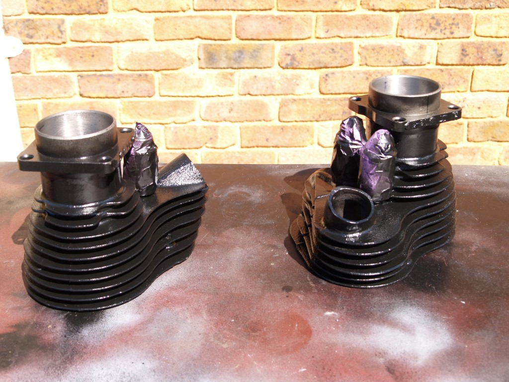

old man emu Posted December 1, 2019 Posted December 1, 2019 Anti-seize????? Why don't you use high temperature gasket sealant? I use it on the joints on my bike's exhaust, even where the exhaust pipe slips into the cylinder. Admittedly, this engine does not have an exhaust manifold, but the sealant has not been weakened by the heat it is exposed to.
