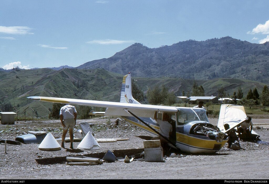

Roundsounds Posted December 13, 2019 Posted December 13, 2019 The pic above is obviously of a past incident. Poor old girl, used and abused!
red750 Posted December 13, 2019 Posted December 13, 2019 RS, posted in the wrong topic. This one is about a crash in NZ. 1

poteroo Posted December 14, 2019 Posted December 14, 2019 'Roundsounds said: I think this is a pic from 1969, a Talair C185 bingle somewhere in the PNG Highlands
