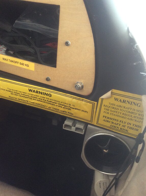

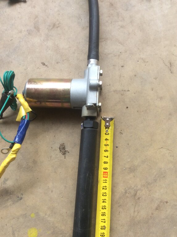

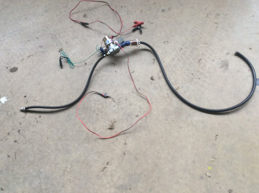

skippydiesel Posted December 16, 2019 Posted December 16, 2019 Photos of the latest & last, modifications of my 12 volt portable refueling pump. Powered from, always live, Anderson plug secured below instrument panel. This plug also doubles as my easy battery charge/jump access. Black poly fittings from local irrigation shop - one riser with female thread one end and reducer nipple to connect to pump. Length to suit jerry can or fuel bladder. Polly fitting unscrews for a more compact system to fly away. Have never tested "lift hight" but in theory a vane pump, being positive displacement, should have no difficulty lifting several metres, with little additional power requirement. I have made up removable "plugs" for the delivery & suction pipe to prevent dust/insect contamination when not in use. 2
onetrack Posted December 16, 2019 Posted December 16, 2019 Skippy, how do you determine when a tank is full, and when/how to shut off the pump? Splash from overflow (along with vapour fumes), poses the greatest risk of fire. You need to ensure there is not the slightest possibility of any sparking in the electrics and connections - how do you manage this? (after seeing a basic toggle switch, which is probably not rated as spark-proof). Anderson plugs are not spark proof, and I can envision that accidental disconnection of the Anderson plug whilst fueling (such as tripping over or stepping on a cable), presents a real ignition-source problem. Personally, I would prefer to see a power connection that is spark-protected, and unable to be accidentally disconnected with just a jerk - such as a twist-lock design connection with a rubber boot. I've had a petrol fire caused by shorting of battery terminals when a metal article was accidentally dropped onto a battery terminal, causing arcing. So, I'm fully aware of how easily fire can start, and how you must ensure that even the slightest possibility of creating an ignition source is countered, when there's open petrol containers, or petrol fumes about.
skippydiesel Posted December 16, 2019 Posted December 16, 2019 Hi Onetrack - NON OF MY home made FUEL TRANSFER SYSTEM is certified or rated in any way. YOU USE IT AT YOUR OWN RISK. Okay having got that out of the way I will give you my view: Potential Spark Generators Jerry can (I use plastic ones from Bunnings Aerospace) should alway be in contact with/on ground to minimise static build up. System earthed to aircraft ground point - if an alligator clip can transmit sufficient current to charge a battery, surely it can provide an effective connection to reduce the chance of a spark - low risk The pump itself - not rated but a copy of a well respected unit (Holly) that has been used in the automotive environment for a squillion years - so pretty safe. The switch - automotive style - fully encased but should be held in the hand opposite to the one holding the delivery hose - so switch ls well away from fumes in "clean" air very low risk of ignition. Delivery hose should be held well into funnel or fuel tank - unlikely spark generator but if occured fuel oxygen/air ratio too high in fuel/low in O2 - will not support combustion. Anderson plug - connected/disconnected befor/after fueling never during - inside cockpit well away from fuel - accidental disconnect unlikely, if sufficient cable used for application (ie cable should never be tight) - low risk On the example you gave - my battery is "buried" behind the instrument panel - nil risk of spark being caused by inadvertent connection of terminals. In your situation (??) why did the positive terminal not have a protective cover ? Your concern about the Anderson plug coming out, are reasonable but if you dont use enough cable or are down right clumsy/unlucky not even a screw in plug is going to prevent damage to the cable which may in turn cause a spark. As for determining full fuel - I guess it's a sight/sound thing - the pump stops delivering fuel the instant it is turned off (so no flow on). I also use a piece of old towel (nice & absorbent) to catch any minor spills - dont like petrol staines on my paint work. To sum up - Yes my home made system probably has a higher risk of fire generation - we all must make these assessment for ourselves. In my case the risk with the alternative/what I used to do, lifting 20 L cans to the hight necessary to transfer fuel, of serious skeletal/muscular damage, of dermatitis and fire from spilt fuel, caused by my aged muscles shaking with the effort, is significantly higher (in fact a given). 1
walrus Posted December 16, 2019 Posted December 16, 2019 Looks to me to be a good setup. The only thing you might like to consider is using an aluminium suction side tube instead of plastic - less chance of spark production. If you are using a recognized fuel hose (ASTM - something) that should have enough conductivity to prevent static build up. Assuming your aircraft battery is earthed to the airframe and the pump frame is also earthed to negative, then you shouldn’t have a spark generating issue - except that poly pipe. If your switch breaks the positive wire, then everything stays connected after switch is off as long as you remove hose from tank before removing the Anderson plug.
skippydiesel Posted December 17, 2019 Posted December 17, 2019 Looks to me to be a good setup. The only thing you might like to consider is using an aluminium suction side tube instead of plastic - less chance of spark production. If you are using a recognized fuel hose (ASTM - something) that should have enough conductivity to prevent static build up. Assuming your aircraft battery is earthed to the airframe and the pump frame is also earthed to negative, then you shouldn’t have a spark generating issue - except that poly pipe. If your switch breaks the positive wire, then everything stays connected after switch is off as long as you remove hose from tank before removing the Anderson plug. Hi Walrus - All true & good advice . The poly pipe "riser: is readily available in a range of lengths & diameters, comes threaded, there are lots of matching plumbing fittings, it is robust (won't crack/bend/squash or corrode) and last but not least, its relativly cheap (as am I). In my installation, the poly pipe is pretty well completely within the fuel container and the little that is above is still in a fuel rich atmosphere, so a spark unlikely to cause ignition. Will have to double check but I am fairly sure the switch "brakes" the positive connection - this would be my normal practice in most 12 V wiring. The fuel hose is 1/2 in Gates fuel hose. Length should be determined by individual application. Fueling my aircraft is now a "doddle" - I have a custom modified funnel with internal filter, (not a Mr Funnel) so all my fuel is filtered as it goes into the tank - its taken quite a while but the filter medium is coming close to needing replacement amazing what it catches. 1
